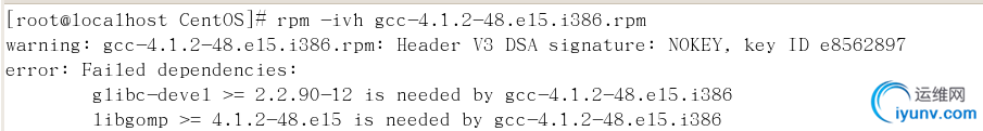

首先先载入CentOS的光盘 然后进入 CentOS目录
rpm -ivh gcc-4.1.2-48.el5.i386.rpm   安装GCC  但是会有依赖关系  无法安装
我们可以用 yum  install gcc
然后安装 yum install gcc-c++

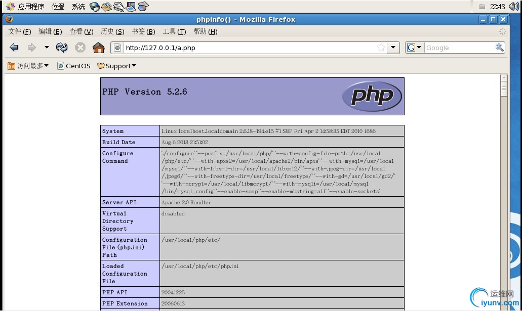

安装php
cd /lamp/php-5.2.6
./configure --prefix=/usr/local/php/ --with-config-file-path=/usr/local/php/etc/ --with-apxs2=/usr/local/apache2/bin/apxs --with-mysql=/usr/local/mysql/ --with-libxml-dir=/usr/local/libxml2/ --with-jpeg-dir=/usr/local/jpeg6/ --with-freetype-dir=/usr/local/freetype/ --with-gd=/usr/local/gd2/ --with-mcrypt=/usr/local/libmcrypt/ --with-mysqli=/usr/local/mysql/bin/mysql_config --enable-soap --enable-mbstring=all --enable-sockets
make
make install
新建phpini文件
cp php.ini-dist /usr/local/php/etc/php.ini
让apache支持php
echo "Addtype application/x-httpd-php .php .phtml" >> /etc/httpd/httpd.conf
重启apache
/usr/local/apache2/bin/apachectl restart
大功告成
