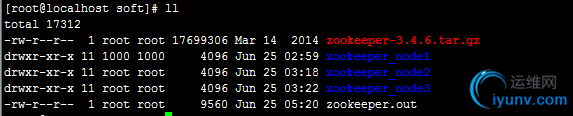

  (1)拷贝3份zookeeper-3.4.6.tar.gz,如zookeeper_node1、zookeeper_node2、zookeeper_node3,结构如下:
