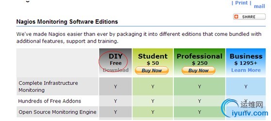

  1 開始下载:
wget http://sourceforge.net/projects/nagios/files/nagios-4.x/nagios-4.0.6/nagios-4.0.6.tar.gz/download?use_mirror=jaist
例如以下图所看到的,下载free版本号的。

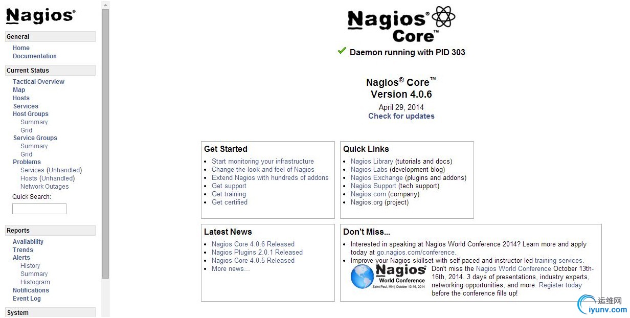

  启动apache服务:
  /usr/local/apache2/bin/apachectl start
  [iyunv@cache-2 php-5.4.26]# /usr/local/apache2/bin/apachectl start
  httpd: Could not reliably determine the server's fully qualified domain name, using 10.254.3.41 for ServerName
  (98)Address already in use: make_sock: could not bind to address [::]:80
  (98)Address already in use: make_sock: could not bind to address 0.0.0.0:80
  no listening sockets available, shutting down
  Unable to open logs
  改动ServerName以及Port
  vi /usr/local/apache2/conf/httpd.conf
  ServerName 改成 10.xx.3.x1
  Listen 80 改成 Listen 81
  http://10.xx.3.x1:81/nagios/,能够打开了,例如以下所看到的:
