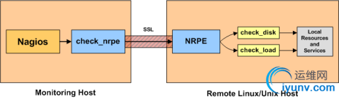

编译安装nrpe(都得装)
  NRPE是nagios的一个扩展,它被用于被监控的服务器上,向nagios监控平台提供该服务器的一些本地的情况。例如,cpu负载、内存使用、硬盘使用等等。NRPE可以称为nagios的for linux 客户端。
apt-get install openssl libssl-dev
tar zxf nrpe-2.15
cd nrpe-2.15
./configure --with-ssl=/usr/bin/openssl --with-ssl-lib=/usr/lib/x86_64-linux-gnu
make all
make install-plugin
make install-daemon
make install-daemon-config
/usr/local/nagios/bin/nrpe -c /usr/local/nagios/etc/nrpe.cfg -d
/usr/local/nagios/libexec/check_nrpe ‐H localhost
NRPE v2.15
  这就说明check_nrpe连接nrpe daemon是正常的,其他被监控的主机都得这样check_nrpe

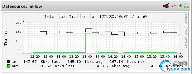

监控网络流量check_iftraffic
  添加Nrpe.cfg
command[check_iftraffic]=/usr/local/nagios/libexec/check_iftraffic -i eth0 -w 5 -c 10 -b 10 -u m
  服务定义
define service{
use                          generic-service
host_name                    localhost
service_description          iftraffic
check_command               check_nrpe!check_iftraffic
  提示unable to read output的, 被控机的/tmp下有个traffic_ifeth*,把他的属主改成nagios就可以了

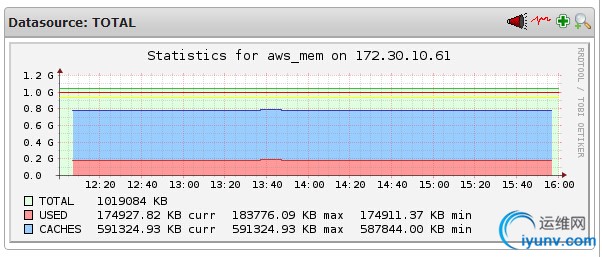

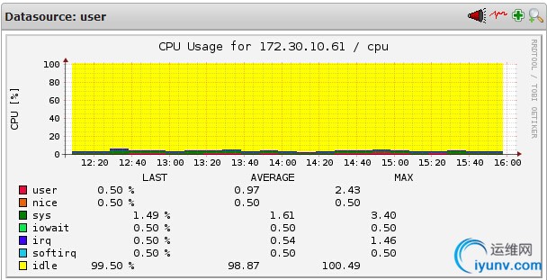

Pnp4nagios安装
  pnp4nagios是基于RRD轮循(环状)数据库中所提供的综合信息,以可视化图形的方式呈现给用户的一款nagios插件

  配置pnp4nagios
cd /usr/local/pnp4nagios/etc/
mv misccommands.cfg-sample misccommands.cfg
mv nagios.cfg-sample nagios.cfg
mv rra.cfg-sample rra.cfg
cd pages/
mv web_traffic.cfg-sample web_traffic.cfg
  可以开启process_perfdata debug模式修改/usr/local/pnp4nagios/etc/process_perfdata.cfg
LOG_LEVEL = 2
  会在/usr/local/pnp4nagios/var/perfdata.log显示错误日志,方便查找原因
  貌似Synchronous Mode在nagios4.x有bug,日志显示一直找不到nagios环境,但是看官方文档更改enable_environment_macros=1应该影响开启nagios环境。
  Bulk配置
  修改nagios.cfg
process_performance_data=1
# service performance data
service_perfdata_file=/usr/local/pnp4nagios/var/service-perfdata
service_perfdata_file_template=DATATYPE::SERVICEPERFDATA\tTIMET::$TIMET$\tHOSTNAME::$HOSTNAME$\tSERVICEDESC::$SERVICEDESC$\tSERVICEPERFDATA::$SERVICEPERFDATA$\tSERVICECHECKCOMMAND::$SERVICECHECKCOMMAND$\tHOSTSTATE::$HOSTSTATE$\tHOSTSTATETYPE::$HOSTSTATETYPE$\tSERVICESTATE::$SERVICESTATE$\tSERVICESTATETYPE::$SERVICESTATETYPE$
service_perfdata_file_mode=a
service_perfdata_file_processing_interval=15
service_perfdata_file_processing_command=process-service-perfdata-file
# host performance data #
host_perfdata_file=/usr/local/pnp4nagios/var/host-perfdata
host_perfdata_file_template=DATATYPE::HOSTPERFDATA\tTIMET::$TIMET$\tHOSTNAME::$HOSTNAME$\tHOSTPERFDATA::$HOSTPERFDATA$\tHOSTCHECKCOMMAND::$HOSTCHECKCOMMAND$\tHOSTSTATE::$HOSTSTATE$\tHOSTSTATETYPE::$HOSTSTATETYPE$
host_perfdata_file_mode=a
host_perfdata_file_processing_interval=15
host_perfdata_file_processing_command=process-host-perfdata-file
  修改commands.cfg
define command{
command_name    process-service-perfdata-file
command_line    /usr/local/pnp4nagios/libexec/process_perfdata.pl --bulk=/usr/local/pnp4nagios/var/service-perfdata
define command{
command_name    process-host-perfdata-file
command_line    /usr/local/pnp4nagios/libexec/process_perfdata.pl --bulk=/usr/local/pnp4nagios/var/host-perfdata
  重启nagios,然后就出图了。

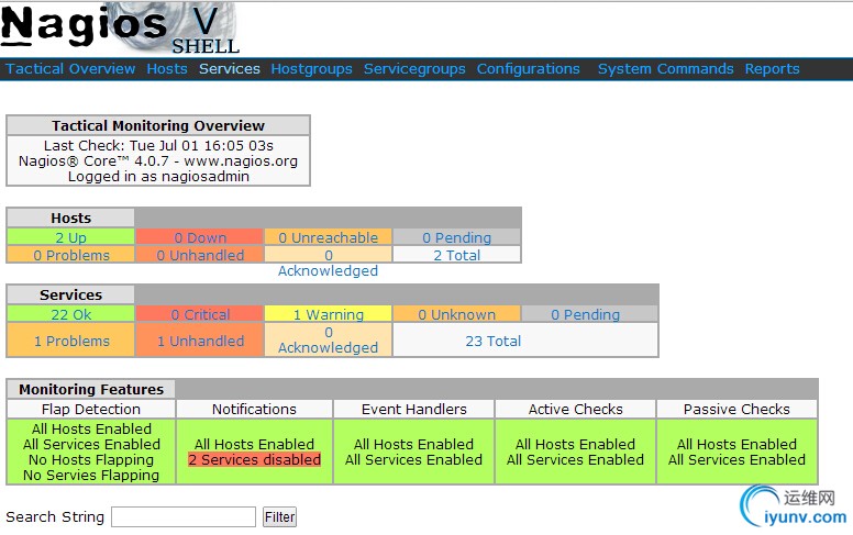

Nagios网页界面之Visual Shell
  Nagios 提供的网页界面是自带的CGI程序,目前只提供英文语言,如果动手修改其排版,或者汉化核心CGI程序(C语言),则每一次版本更新都需要进行更改,这将是非常繁锁的工作。为了解决这个问题,我们可以通过读取Nagios监控系统的状态信息,即var/status.dat文件,根据其中的字段值来重新设计显示界面。
  Nagios Visual shell (Vshell)是一个使用PHP编写的轻量级开源Nagios网页前端,输出的XHTML+CSS代码可以通过W3C标准验证。个人认为,Vshell的界面配色很一般,看一会儿就是会觉得很辛苦,以后的版本还需要加强美工。
  apt-get install php-apc
  V-Shell takes advantage of the Alternative PHP Cache system (APC), which is of particular importance if you are managing a large installation.
  You may need to increase your PHP 'memory_limit' setting in your system's php.ini file if you're using APC.  For large systems try a setting as high as 256-512MB.
wget http://assets.nagios.com/downloads/exchange/nagiosvshell/vshell.tar.gz
tar zxf vshell.tar.gz
cd vshell
  修改install.php
define('TARGETDIR',"/usr/local/vshell");
define('APACHECONF',"/etc/httpd/conf.d");       (centos)
define('APACHECONF',"/etc/apache2/conf.d");   (ubuntu)
chmod +x install.php
./install.php
