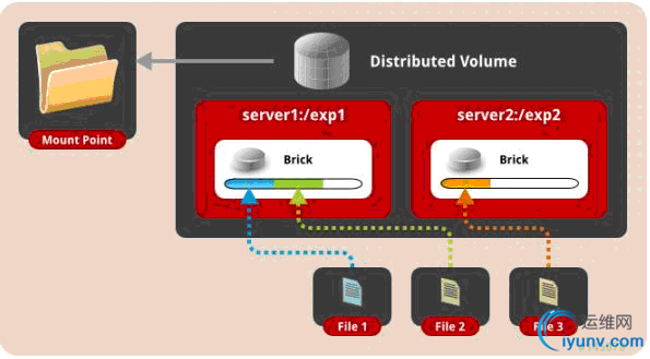

  第一,分佈卷
  在分布式卷文件被随机地分布在整个砖的体积。使用分布式卷,你需要扩展存储,冗余是重要或提供其他硬件/软件层。(簡介:分布式卷,文件通过hash算法随机的分布到由bricks组成的卷上。卷中资源仅在一台服务器上存储,在存储池中非镜像或条带模式。)
  (In a distributed volumes files are spread randomly across the bricks in the volume. Use distributed volumes where you need to scale storage and redundancy is either not important or is provided by other hardware/software layers.
  Note
  Disk/server failure in distributed volumes can result in a serious loss of data because directory contents are spread randomly across the bricks in the volume.)
  Create the distributed volume:
  # gluster volume create NEW-VOLNAME [transport [tcp | rdma | tcp,rdma]]
  NEW-BRICK...
  For example, to create a distributed volume with four storage servers using tcp:
  # gluster volume create test-volume server1:/exp1 server2:/exp2 server3:/exp3 server4:/exp4
  Creation of test-volume has been successful
  Please start the volume to access data.
  (Optional) You can display the volume information:
  # gluster volume info
  Volume Name: test-volume
  Type: Distribute
  Status: Created
  Number of Bricks: 4
  Transport-type: tcp
  Bricks:
  Brick1: server1:/exp1
  Brick2: server2:/exp2
  Brick3: server3:/exp3
  Brick4: server4:/exp4

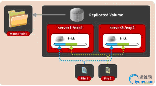

  第二,復制卷
  复制卷创建跨多个砖的体积的文件的副本。您可以使用复制卷在环境中的高可用性和高可靠性是至关重要的。(簡介:复制式卷,类似raid1,replica数必须等于volume中brick所包含的存储服务器数,可用性高。创建一个两两互为备份的卷,存储池中一块硬盘损坏,不会影响到数据的使用,最少需要两台服务器才能创建分布镜像卷。)
  (Replicated volumes create copies of files across multiple bricks in the volume. You can use replicated volumes in environments where high-availability and high-reliability are critical.
  Note
  The number of bricks should be equal to of the replica count for a replicated volume. To protect against server and disk failures, it is recommended that the bricks of the volume are from different servers.)
  (如圖,File1同時存儲在server1和server2上。 File2也是如此。相當於server2中的文件是server1中文件的副本。)
  Create the replicated volume:
  # gluster volume create NEW-VOLNAME [replica COUNT] [transport [tcp |
  rdma | tcp,rdma]] NEW-BRICK...
  For example, to create a replicated volume with two storage servers:
  # gluster volume create test-volume replica 2 transport tcp server1:/exp1 server2:/exp2

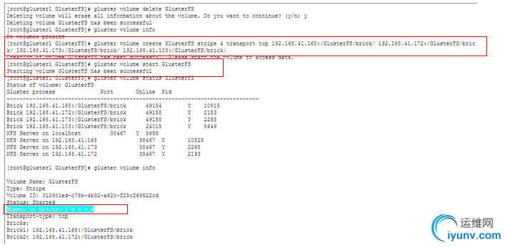

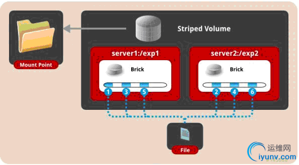

  第三,条带卷
  条带卷条纹砖之间的数据的容量。为了达到最佳效果,你应该使用条带卷,只有在高并发环境下,访问非常大的文件。(簡介:条带式卷,类似与raid0,stripe数必须等于volume中brick所包含的存储服务器数,文件被分成数据块,以Round Robin的方式存储在bricks中,并发粒度是数据块,大文件性能好。)
  (Striped volumes stripes data across bricks in the volume. For best results, you should use striped volumes only in high concurrency environments accessing very large files.
  Note
  The number of bricks should be a equal to the stripe count for a striped volume.)
  Create the striped volume:
  # gluster volume create NEW-VOLNAME [stripe COUNT] [transport [tcp |
  For example, to create a striped volume across two storage servers:
  # gluster volume create test-volume stripe 2 transport tcp server1:/exp1 server2:/exp2

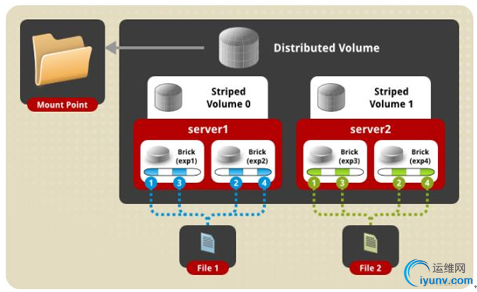

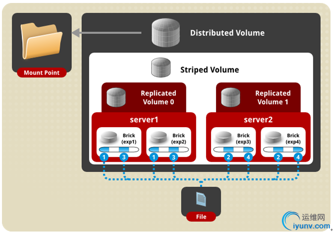

  第四,分佈式条带卷(復合型)
  分布式条带卷条带文件在集群中的两个或两个以上的节点。为了达到最佳效果,你应该使用分布式条带卷的要求是扩展存储和高访问非常大的文件的并发环境是至关重要的。(簡介:分布式的条带卷,volume中brick所包含的存储服务器数必须是stripe的倍数(>=2倍),兼顾分布式和条带式的功能。每个文件分布在四台共享服务器上,通常用于大文件访问处理,最少需要 4 台服务器才能创建分布条带卷。)
  (Distributed striped volumes stripes files across two or more nodes in the cluster. For best results,you should use distributed striped volumes where the requirement is to scale storage and in high concurrency environments accessing very large files is critical.
  Note
  The number of bricks should be a multiple of the stripe count for a distributed striped volume.)

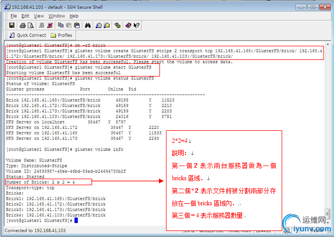

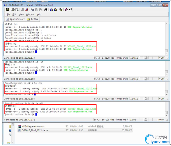

  Create the distributed striped volume:
  For example, to create a distributed striped volume across eight storage servers:
  # gluster volume create test-volume stripe 4 transport tcp server1:/exp1 server2:/exp2
  server3:/exp3 server4:/exp4 server5:/exp5 server6:/exp6 server7:/exp7 server8:/exp8

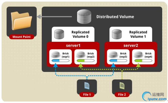

  第五,分布式復制卷(復合型)
  分配文件在复制砖的体积。您可以使用分布式复制卷要求规模的环境中存储和高可靠性是至关重要的。分布复制卷也提供了更好的读取性能在大多数环境
  。(簡介:分布式的复制卷,volume中brick所包含的存储服务器数必须是 replica 的倍数(>=2倍),兼顾分布式和复制式的功能。)
  (Distributes files across replicated bricks in the volume. You can use distributed replicated volumes in environments where the requirement is to scale storage and high-reliability is critical. Distributed replicated volumes also offer improved read performance in most environments.
  Note
  The number of bricks should be a multiple of the replica count for a distributed replicated volume. Also, the order in which bricks are specified has a great effect on data protection. Each replica_count consecutive bricks in the list you give will form a replica set, with all replica sets combined into a volume-wide distribute set. To make sure that replica-set members are not placed on the same node, list the first brick on every server, then the second brick on every server in the same order, and so on.)
  Create the distributed replicated volume:
  For example, four node distributed (replicated) volume with a two-way mirror:
  # gluster volume create test-volume replica 2 transport tcp server1:/exp1 server2:/exp2 server3:/exp3 server4:/exp4
  For example, to create a six node distributed (replicated) volume with a two-way mirror:
  # gluster volume create test-volume replica 2 transport tcp server1:/exp1 server2:/exp2 server3:/exp3 server4:/exp4 server5:/exp5 server6:/exp6

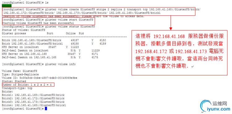

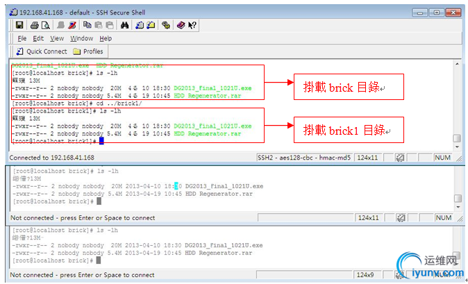

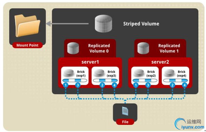

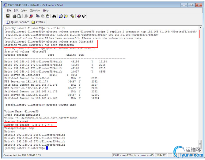

  第六, 条带復制卷(復合型)
  条带復制卷条带数据在复制集群中的砖。为了达到最佳效果,你应该使用条纹复制卷在高并发环境下并行访问非常大的文件和性能是至关重要的。在此版本中,这种类型的卷配置仅支持地图减少工作量。
  (Striped replicated volumes stripes data across replicated bricks in the cluster. For best results, you should use striped replicated volumes in highly concurrent environments where there is parallel access of very large files and performance is critical. In this release, configuration of this volume type is supported only for Map Reduce workloads.
  Note
  The number of bricks should be a multiple of the replicate count and stripe count for a striped replicated volume.)
  Create a striped replicated volume :
  # gluster volume create NEW-VOLNAME [stripe COUNT] [replica COUNT]
  [transport [tcp | rdma | tcp,rdma]] NEW-BRICK...
  For example, to create a striped replicated volume across four storage servers:
  # gluster volume create test-volume stripe 2 replica 2 transport tcp server1:/exp1
  To create a striped replicated volume across six storage servers:
  # gluster volume create test-volume stripe 3 replica 2 transport tcp server1:/exp1
