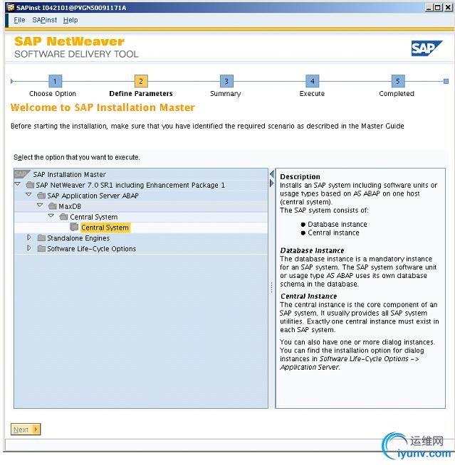

2.     Start the Installer in  <extract_folder>\SAP_NetWeaver701SR1_2008_Installation_Master\IM_WINDOWS_I386\sapinst.exe.
3.     Choose "SAP Application Server ABAP" --> MaxDB --> Central System --> "Central System".
4.     Follow the instructions and provide the necessary input in the sapinst dialog wizard.

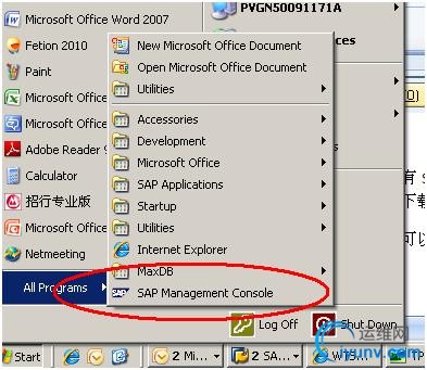

9.     After the installation has finished, the application server should be started automatically. You may start and stop the server with the SAP Microsoft Management Console. The Application Server should appear green in your SA
10.   P MMC. If it is grey, start the server and database. If it is yellow, the server starts. If it is stays yellow the setup failed or the database (MaxDB Windows Service NSP, Windows process kernel.exe) is down. If it is red, the license is invalid.

装的时候会提示你系统不满足要求,不用管直接跳过去。
当中有一步会让你输入一个统一的Password,其实就是你在装系统时,操作系统用户nspadm和SAPServiceNSP的密码,还有MaxDB数据库用户:superdba和control用户的密码。
这个安装界面还是很人性化的,一步步都显示得很清楚。

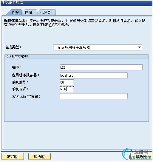

装完以后如果你有SAP GUI 客户端,就能够配置了。配置的方法在安装文档里面有,其实就是设置一个本地的地址,然后把System Number,System ID配上去就行了。系统标识默认是NSP,如果你在安装的时候修改了,就要按照你修改的来配置。

然后就可以连接了:
当然,连接之前还需要确认你已经载SAP Management Console里启动了SAP Instance.
