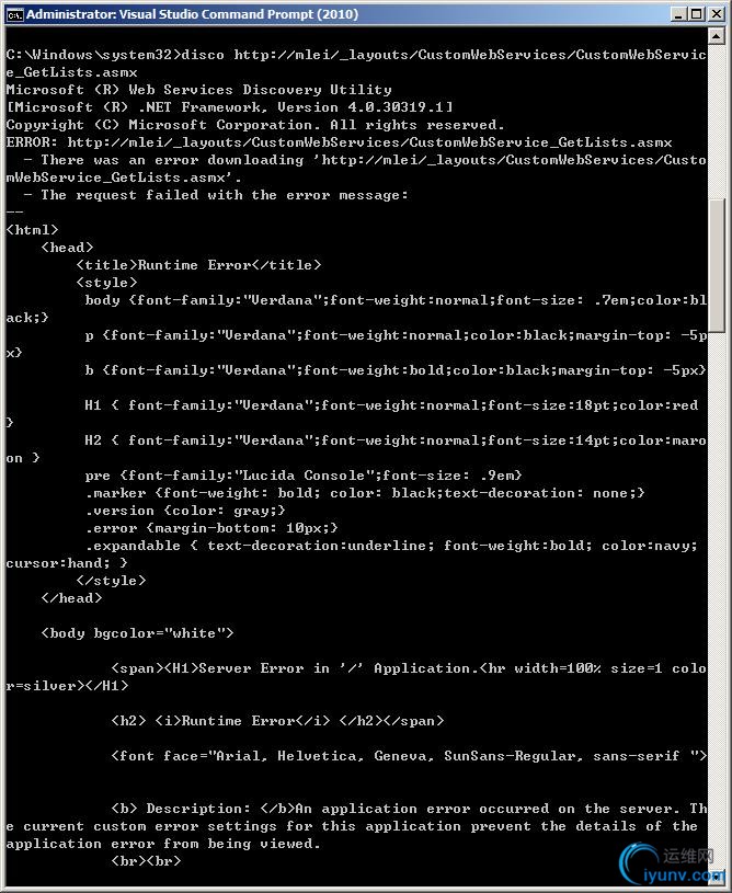

1.Disco.exe:
           When using the commond:
  disco http://localhost/_layouts/*.asmx
           There is an error as follow:
Reason:
  In the *.asmx file,
<%@ WebService Language="C#" Class="CustomWebServiceLib.CustomWebService_GetLists" %>
Solution:
  Change to:
<%@ WebService Language="C#" Class="CustomWebServiceLib.CustomWebService_GetLists, CustomWebServiceLib, Version=1.0.0.0, Culture=neutral, PublicKeyToken=fbe2e565a3b3e37d" %>

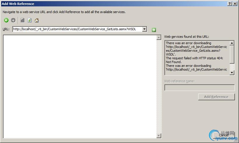

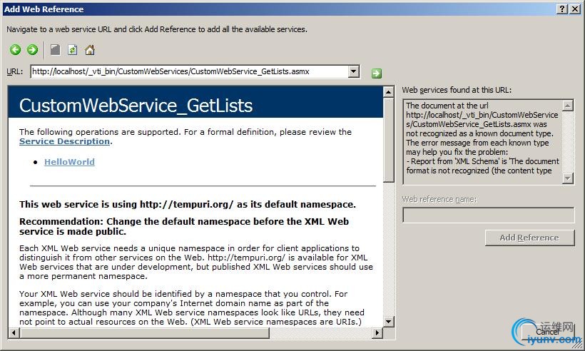

2.Add Web Reference:
Error message:
  The document at the url
  http://localhost/_vti_bin/CustomWebServices/CustomWebService_GetLists.asmx
  was not recognized as a known document type.
  The error message from each known type may help you fix the problem:
  - Report from 'XML Schema' is 'The document format is not recognized (the content type
Screenshot:
  Click &#8220;Service Description&#8221;:
Reason:
  When converting *.disco to *disco.aspx and *.wsdl to *wsdl.aspx, there are some errors.
Solution:
  You can copy the files of the system services, then rename the files;
  Update the service name in the binding tags to your service name.
