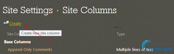

  • Click on Create and Create a new Site Column
  • Type in a Distinguished name and Select the type in this column is Lookup

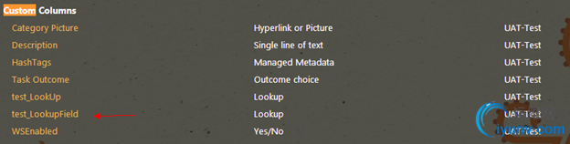

  • Check it Whether Exist in Custom Columns Group

  • Success.Look up column looking for values of a list/library on another parent site.
