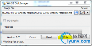

  To flash your SD Card, you will need to unzip the image and write it your SD card using Win32DiskImager. This tool can also be used to after our initial setup to create an image of our finalized implementation(very useful as a backup).

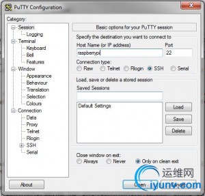

  After the image is flashed, you can boot your device. At this point you can use your HDMI Cable/Mouse/Keyboard for your initial configuration, or you can use an SSH Client like Putty to connect. The default hostname, login, and password are as follows:
  host:raspberrypi
Username: pi
Password: raspberry

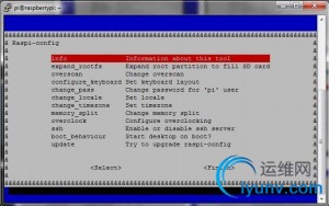

  For this tutorial, I will be using putty. On first boot, you will be prompted with a configuration tool called Raspi-Config. If the raspi-config doesnt load automatically, just enter the following command from the shell to get started.
sudo raspi-config
  The settings I recommend you update are
  update
expand_rootfs
change_pass
change_timezone
memory_split
  The usual distribution images are 2 GB. When you copy the image to a
larger SD card you have a portion of that card unused. expand_rootfs
expands the initial image to expand to fill the rest of the SD card,
giving you more space. By default, 64mb is reserved for the Graphical
UI. Since we plan on using this as a WiFi Hotspot, we can reduce this to
32mb with the memory_split command.

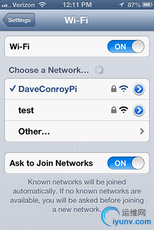

  That should do it! I’m happy to answer any questions, just comment on this post. Thanks for reading! DSC0004.png
