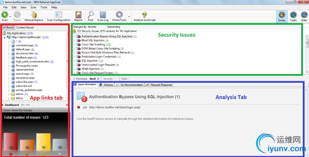

  The screen can be divided roughly into 3 panes: Application Links, Security Issues, and Analysis.
  Application Links Pane
  Under this, the hierarchical structure of the website is shown. The folders and files of the application are shown in both URL based and content based form. The number of security issues or vulnerabilities present on each link is shown adjacent to it in brackets. By right clicking on a URL or folder you can choose to exclude it from the scan if you are rescanning the application.
  The ‘Dashboard’ section will list the total number of issues present based on their severity: High, Medium, Low and informational. So the dashboard will reflect the overall strength of an application.
  Security Issues Pane
  This tab presents details about the vulnerabilities present in the application. For each vulnerability, the vulnerable pages are listed and the parameters are identified. This can be seen by expanding a particular vulnerability issue as shown below.
  Based on the scan configuration, Appscan identifies various kinds of vulnerabilities ranging from critical issues like ‘SQL Injection’ to low severity vulnerabilities like ‘Email Address Pattern Found’. Because the scan policy selected by us is ‘Default’, Appscan shows us all kinds of vulnerabilities. By right clicking on a particular vulnerability you can change the severity, mark it as non-vulnerable and even delete it.
  Analysis Pane
  By selecting a particular issue in the security issues tab, the corresponding details can be seen in the analysis pane. These are listed in the following tabs: Issue information, Advisory, Fix Recommendation, Request/Response.

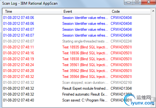

  Scan Log records every action performed by Appscan (refer to the figure below). So using this feature, you can track all the activities. For instance, while the scan is running you can view precisely what the Appscan is looking for.

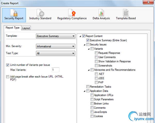

  Generating Reports
  At the end of the analysis, you can generate a report of all the valid findings, including the remediation steps that need to be followed in order to fix the issues. These reports can be customized to suit your needs. For instance, you set a template for the development team which is different from a template set for your application manager. Appscan allows you to include various customized fields such as company logo, cover page, report title, etc.
  As shown in the above figure, you can include all the parameters that you would like to see by selecting them. The other details under this section are easily understandable.
