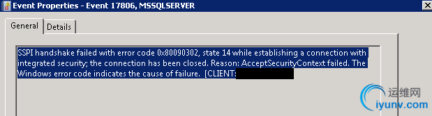

SSPI handshake failed with error code 0x8009030c, state 14 while establishing a connection with integrated security; the connection has been closed. Reason: AcceptSecurityContext failed. The Windows error code indicates the cause of failure.  [CLIENT: xx.xx.xx.xx].

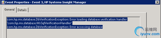

  Yes, it doesn't work suddently, SIM service still running with some errors in eventlog,
com.hp.mx.database.DbVerificationException: Error loading database verification handler 'com.hp.mx.database.MsSqlVerificationHandler'
com.hp.mx.database.DbVerificationException: Error accessing database
SSPI handshake failed with error code 0x80090302, state 14 while establishing a connection with integrated security; the connection has been closed. Reason: AcceptSecurityContext failed. The Windows error code indicates the cause of failure.  [CLIENT: xxxxxxx].
  Screenshot attached,

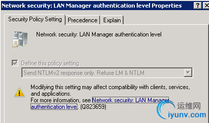

  Question is why the problem just pop-up? Nobody rarely touch a server like SIM, so launch rsop.msc to check policies related to NTLM.
  The default values from "explain",
Windows 2000 and windows XP: send LM & NTLM responses
Windows Server 2003: Send NTLM response only
Windows Vista, Windows Server 2008, Windows 7, and Windows Server 2008 R2: Send NTLMv2 response only
  Generally speaking, Windows servers will negoiate with each other, make decision for potocol, then start exchanging data, but this time the policy changed to "Refuse LM & NTLM", therefore server refused authentication from SIM service.
