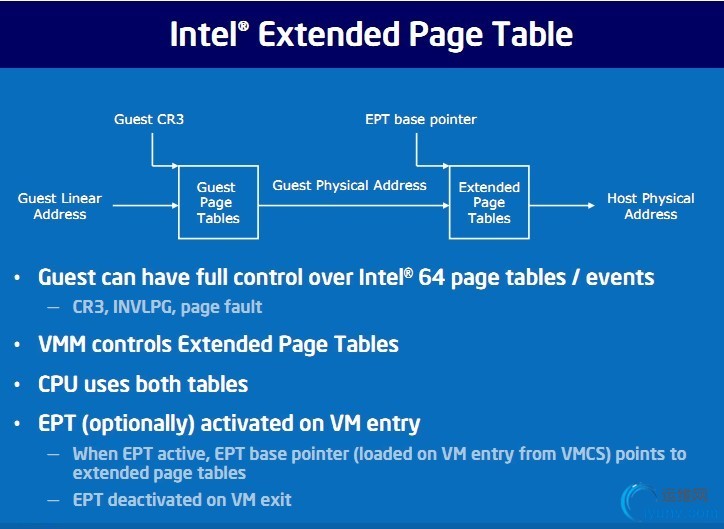

1. Overview of EPT
  CPU will use both guest page table and extended page table. The address of EPT is set by the function vmx_set_cr3.

EPT (optionally) activated on VM entry
– When EPT active, EPT base pointer (loaded on VM entry from VMCS) points to extended page tables
– EPT deactivated on VM exit

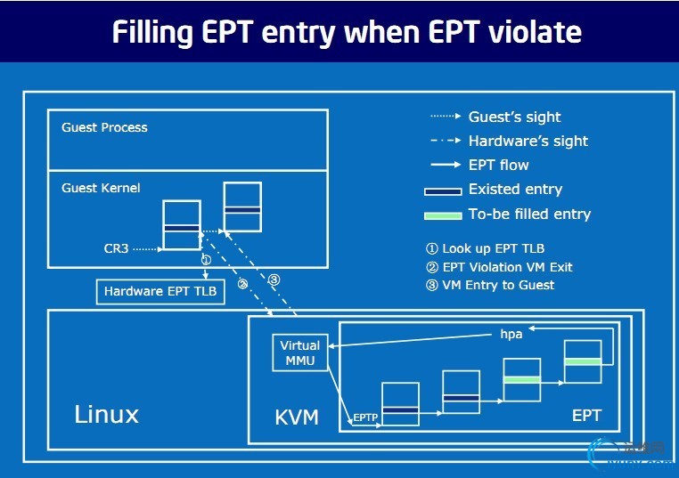

  2. EPT is built dynamically and reuse the shadow page code in kvm
  EPT is set up by using ept violation vm exit. It maps the gpa directly with the hpa on the host in the ept.

  3. All guest physical address go through extended page table, including cr3, address in PDE and PTE.
