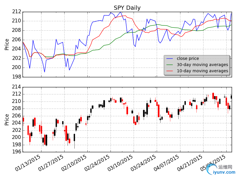

1. SPY的均线和candlestick图
from __future__ import print_function, division
import numpy as np
import pandas as pd
import datetime as dt
import pandas.io.data as web
import matplotlib.finance as mpf
import matplotlib.dates as mdates
import matplotlib.mlab as mlab
import matplotlib.pyplot as plt
import matplotlib.font_manager as font_manager
starttime = dt.date(2015,1,1)
endtime = dt.date.today()
ticker = 'SPY'
fh = mpf.fetch_historical_yahoo(ticker, starttime, endtime)
r = mlab.csv2rec(fh); fh.close()
r.sort()
df = pd.DataFrame.from_records(r)
quotes = mpf.quotes_historical_yahoo_ohlc(ticker, starttime, endtime)
fig, (ax1, ax2) = plt.subplots(2, sharex=True)
tdf = df.set_index('date')
cdf = tdf['close']
cdf.plot(label = "close price", ax=ax1)
pd.rolling_mean(cdf, window=30, min_periods=1).plot(label = "30-day moving averages", ax=ax1)
pd.rolling_mean(cdf, window=10, min_periods=1).plot(label = "10-day moving averages", ax=ax1)
ax1.set_xlabel(r'Date')
ax1.set_ylabel(r'Price')
ax1.grid(True)
props = font_manager.FontProperties(size=10)
leg = ax1.legend(loc='lower right', shadow=True, fancybox=True, prop=props)
leg.get_frame().set_alpha(0.5)
ax1.set_title('%s Daily' % ticker, fontsize=14)
mpf.candlestick_ohlc(ax2, quotes, width=0.6)
ax2.set_ylabel(r'Price')
for ax in ax1, ax2:
fmt = mdates.DateFormatter('%m/%d/%Y')
ax.xaxis.set_major_formatter(fmt)
ax.grid(True)
ax.xaxis_date()
ax.autoscale()
fig.autofmt_xdate()
fig.tight_layout()
plt.setp(plt.gca().get_xticklabels(), rotation=30)
plt.show()
fig.savefig('SPY.png')

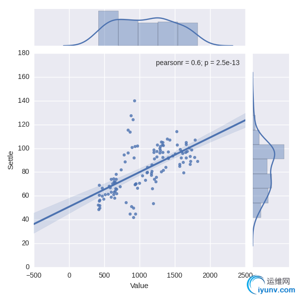

  2. 近十年中纽约商业交易所(NYMEX)原油期货价格和黄金价格的线性回归关系
import numpy as np
import pandas as pd
import Quandl
import seaborn as sns
sns.set(style="darkgrid")
token = "???" # Notice: You can get the token by signing up on Quandl (https://www.quandl.com/)
starttime = "2005-01-01"
endtime = "2015-01-01"
interval = "monthly"
gold = Quandl.get("BUNDESBANK/BBK01_WT5511", authtoken=token, trim_start=starttime, trim_end=endtime, collapse=interval)
nymex_oil_future = Quandl.get("OFDP/FUTURE_CL1", authtoken=token, trim_start=starttime, trim_end=endtime, collapse=interval)
brent_oil_future = Quandl.get("CHRIS/ICE_B1", authtoken=token, trim_start=starttime, trim_end=endtime, collapse=interval)
#dat = nymex_oil_future.join(brent_oil_future, lsuffix='_a', rsuffix='_b', how='inner')
#g = sns.jointplot("Settle_a", "Settle_b", data=dat, kind="reg")
dat = gold.join(nymex_oil_future, lsuffix='_a', rsuffix='_b', how='inner')
g = sns.jointplot("Value", "Settle", data=dat, kind="reg")

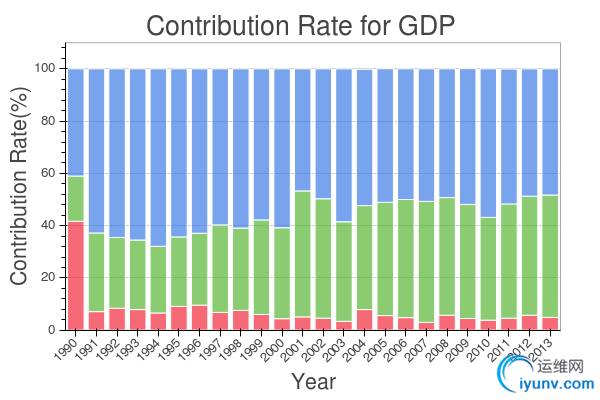

  3. 我国三大产业对于GDP的影响
from collections import OrderedDict
import numpy as np
import pandas as pd
import tushare as ts
from bokeh.charts import Bar, output_file, show
import bokeh.plotting as bp
df = ts.get_gdp_contrib()
df = df.drop(['industry', 'gdp_yoy'], axis=1)
df = df.set_index('year')
df = df.sort_index()
years = df.index.values.tolist()
pri = df['pi'].astype(float).values
sec = df['si'].astype(float).values
ter = df['ti'].astype(float).values
contrib = OrderedDict(Primary=pri, Secondary=sec, Tertiary=ter)
years = map(unicode, map(str, years))
output_file("stacked_bar.html")
bar = Bar(contrib, years, stacked=True, title="Contribution Rate for GDP", \
xlabel="Year", ylabel="Contribution Rate(%)")

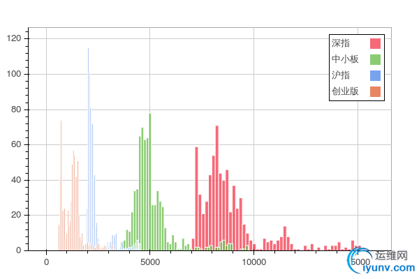

  4. 国内沪指,深指等几大指数分布
  # -*- coding: utf-8 -*-
from __future__ import unicode_literals
import pandas as pd
from bokeh.charts import Histogram, output_file, show
sh = ts.get_hist_data('sh')
sz = ts.get_hist_data('sz')
zxb = ts.get_hist_data('zxb')
cyb = ts.get_hist_data('cyb')
df = pd.concat([sh['close'], sz['close'], zxb['close'], cyb['close']], \
axis=1, keys=['sh', 'sz', 'zxb', 'cyb'])
fst_idx = -700
distributions = OrderedDict(sh=list(sh['close'][fst_idx:]), cyb=list(cyb['close'][fst_idx:]), sz=list(sz['close'][fst_idx:]), zxb=list(zxb['close'][fst_idx:]))
df = pd.DataFrame(distributions)
col_mapping = {'sh': u'沪指',
'zxb': u'中小板',
'cyb': u'创业版',
'sz': u'深指'}
df.rename(columns=col_mapping, inplace=True)
output_file("histograms.html")
hist = Histogram(df, bins=50, density=False, legend="top_right")
show(hist)

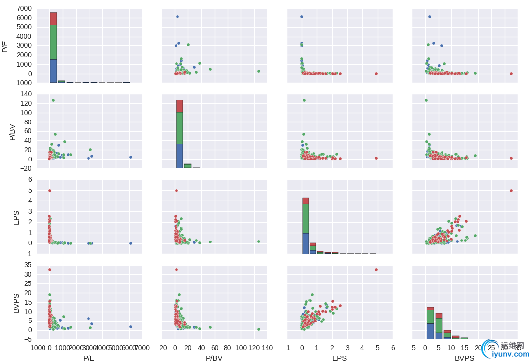

  5. 选取某三个行业中上市公司若干关键指标(市盈率,市净率等)的相关性
import numpy as np
import pandas as pd
cls = ts.get_industry_classified()
stk = ts.get_stock_basics()
cls = cls.set_index('code')
tcls = cls[['c_name']]
tstk = stk[['pe', 'pb', 'esp', 'bvps']]
df = tcls.join(tstk, how='inner')
clist = [df.ix['c_name'] for i in xrange(3)]
def neq(a, b, eps=1e-6):
return abs(a - b) > eps
tdf = df.loc[df['c_name'].isin(clist) & neq(df['pe'], 0.0) & \
neq(df['pb'], 0.0) & neq(df['esp'], 0.0) & \
neq(df['bvps'], 0.0)]
col_mapping = {'pe' : u'P/E',
'pb' : u'P/BV',
'esp' : u'EPS',
'bvps' : u'BVPS'}
tdf.rename(columns=col_mapping, inplace=True)
sns.pairplot(tdf, hue='c_name', size=2.5)
