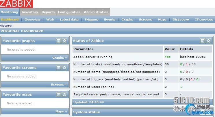

chkconfig zabbix_server on
service zabbix_server restart

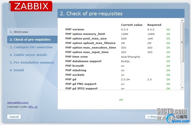

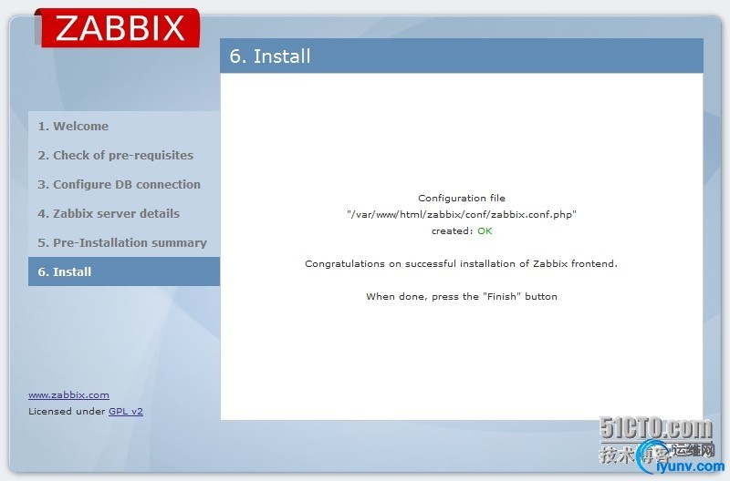

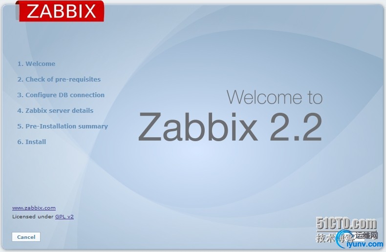

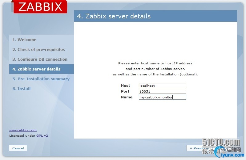

8、通过WEB配置Zabbix-Server
http://8.8.8.109/zabbix
修改/etc/php.ini后,重启httpd服务
service httpd restart
