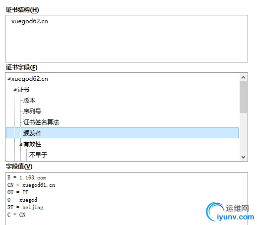

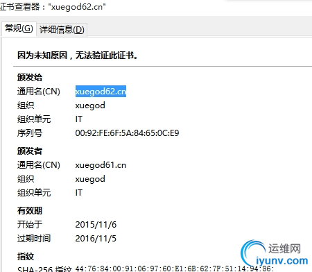

测试
查看端口号:
[iyunv@xuegod62 ~]# netstat -anupt |grep 443
tcp        0      0 :::443                      :::*                        LISTEN      49865/httpd
