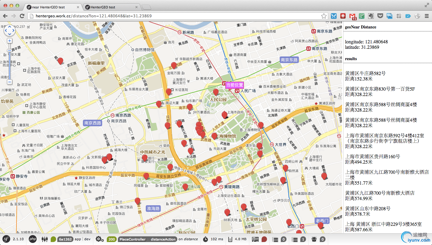

Symfony2演示代码:
/** * @Route(&quot;/distance&quot;, name=&quot;distance&quot;) * @Template() */ public function distanceAction(){  $longitude = (float)$this->getRequest()->get('lon',121.4905); $latitude = (float)$this->getRequest()->get('lat',31.2646); //2km $max = (float)$this->getRequest()->get('max', 2);  $places = $this->getPlaceRepository()->createQueryBuilder() ->field('coordinate') ->geoNear($longitude, $latitude) ->spherical(true) ->distanceMultiplier(6371) ->maxDistance($max/6371) ->limit(100) ->getQuery() ->execute() ->toArray();  return compact('places','longitude', 'latitude', 'max'); }
通过 domian.dev/distance 访问,效果如下:
距离xxx米
