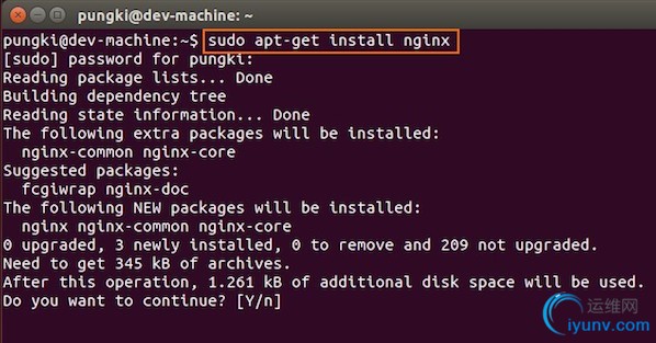

#1 - Download and Install Nginx
The easiest way to download and install Nginx is using apt-get
command. Here is the command:
sudo apt-get install nginx
Fig.01: Download and Install Nginx on Ubuntu Linux
Just wait until installation is get done on the system.

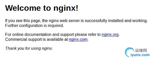

#2 - Test Nginx
Once it get done, you can open your browser and type url http://localhost or http://your_ip_address to test it. If everything goes normal, you will see Nginx welcome page:
Fig.02: Welcome nginx page on Ubuntu Linux

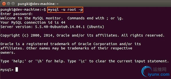

#2 - Test MySQL
Once mysql installation finished, we can test it. Open your console and type the following command:
mysql -u root -p
Fig.04: Ubuntu test Mysql installation
If you type your password correctly, the you will see the mysql prompt.

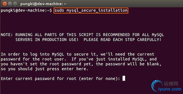

#3 - Securing access to MySQL
If we are going to use MySQL as a production database, we may want to secure it. MySQL provides a shell script to help us securing it. Just type the following command on your console:
sudo mysql_secure_installation
Here are the steps to do it.
1. Enter your root password
Enter your current root password to continue to the next step.

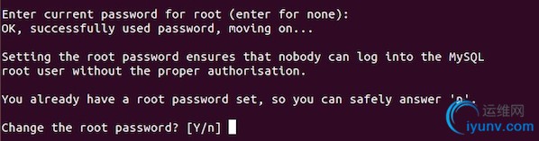

2.Change the root password
If you want to change it, press Y. Otherwise, press N.

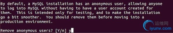

3.Remove anonymous user
It is recommended to remove anonymous user to mitigate risk who can log in into your database.

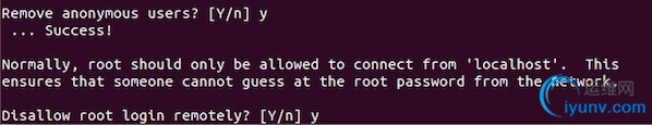

4.Disallow root login remotely
To make sure that no one remote your database as root from another machines, we need to disallow root login remotely.

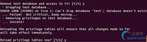

5.Remove test database
Sometimes some MySQL installation will create a database named ëtestí for testing purpose. We can remove it if we donít use it.
Fig.09: MySQL security

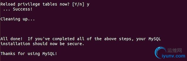

6.Reload privilege tables
Then we need to reloading the privilege tables to ensure all changes made so far will take effect immediately.
Fig.10: MySQL security
7.Done
Fig.11: MySQL security

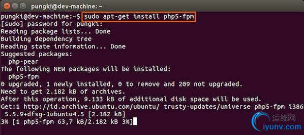

As usual, we can download and install PHP using apt-get command. Just type the following command on your Ubuntu console or over the ssh based session:
sudo apt-get install php5-fpm
Fig.12: Install PHP for Server Side Processing on Ubuntu
And wait for the installation to complete.

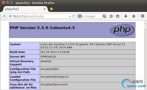

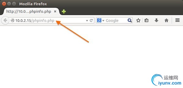

After the configuration section is done, now we need to test them to make sure that our configuration is working as required. On Ubuntu 14.04 the root document folder is located in /usr/share/nginx/html. So create a file called /usr/share/nginx/html/phpinfo.php
with the following code:
<? phpinfo(); ?>
After restarting PHP-FPM and Nginx, open the browser and browse to the php file, we got only a blank screen. No error message on the screen. No error message on PHP-FPM and Nginx log file.
Then we changed /usr/share/nginx/html/phpinfo.php file code on the root document of Nginx, as follows:
<?php phpinfo(); ?>
And then open the browser again and type url http://your_ip_address/phpinfo.php

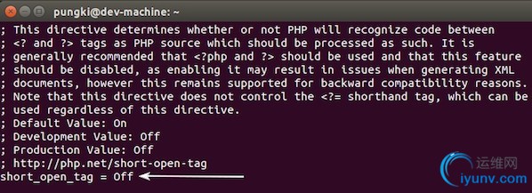

It seem that by default, we can not use short php-tag like this:
<? ... your code ... ?>
To enable short php tag, we need to change the value of short_open_tag parameter on php.ini file:
Change the value from Off to On. Then restart your php5-fpm :
sudo
service php5-fpm restart

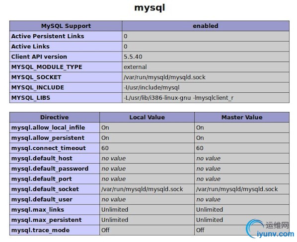

Then try again to test your phpinfo file. Next, we will see if the MySQL support is enabled or not. Scroll down the php configuration screen on your browser, if you see MySQL block there, then MySQL support already enabled.
