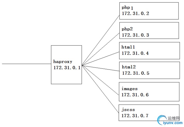

三 ACL
acl <aclname> <criterion> [flag] [operator] <value>
flag
  -i 忽略字符大小写.
type of values
  - integers or integer ranges
ranges 1024:2000
operators eq ge gt le lt
  - string
  - regular expressions
  - IP address and network
criterion 检查标准:
  - dst <ip_address>
  - dst_port <interger>
  - src <ip_address>
  - src_port <interfer>
  - hdr(header) <string> 精确匹配首部字段的&#20540;
acl aaaa hdr(Connection) -i close
  - hdr_reg(headet) <regex> 正则表达式匹配首部的&#20540;
        acl aaaa hdr(Host) -i .*\.magedu.com
  - method <string> 匹配请求的方法
  - path <string> 匹配url中的path部分
  acl indexacl path /index.html
  - path_beg <string> 匹配url中的path以什么开始
acl admin_page path_beg /admin
  - path_end <string> 匹配URL中的path以什么结束
acl phpacl path_end .php
acl htmlacl path_end .html
  - path_reg <regex> 对path进行正则匹配
acl phpacl path_reg .php$
acl htmlacl path_reg .html$
  - url <string> 对URL精确匹配 path&#43;query
  - url_beg <string>
  - url_end <string>
  - url_reg <string>
实现访问控制:
- http-request if | unless conndation 基于7layer过滤
- tcp-request content accept if | unless condation 基于4layer过滤
An Example:
acl url_static path_beg /static /images /img /css
acl url_static path_end .gif .png .jpg .css .js
acl host_www hdr_beg(host) -i www
acl host_static hdr_beg(host) -i img. video. download.
use_backend static if host_static or host_www
  配置案例:
global
log 127.0.0.1 local2
pidfile /var/run/haproxy.pid
maxconn 4000
user haproxy
group haproxy
daemon
defaults
mode http
log global
option httplog
option dontlognull
option http-server-close
option forwardfor except 127.0.0.0/8
option redispatch
retries 3
timeout http-request 10s
timeout queue 1m
timeout connect 10s
timeout client 1m
timeout server 1m
timeout http-keep-alive 10s
timeout check 10s
maxconn 3000
frontend webserver
bind *:80
acl php path_end .php
acl html path_end .html
acl jc path_end .js .css
use_backend dynamic if php
use_backend static if html
use_backend images if image
use_backend jscss if jc
default_backend static
backend dynamic
balance roundrobin
server php1 172.31.0.2:80 check inter 2000 rise 5 fall 2 weight 1
server php2 172.31.0.3:80 check inter 2000 rise 5 fall 2 weight 1
server error 127.0.0.1:80 backup weight 1
backend static
balance roundrobin
server html1 172.31.0.4:80 check inter 2000 rise 5 fall 2 weight 1
server html2 172.31.0.5:80 check inter 2000 rise 5 fall 2 weight 1
backend images
balance roundrobin
server image 172.31.0.6:80 check inter 2000 rise 5 fall 2 weight 1
backend jscss
balance roundrobin
server js_css 172.31.0.17:80 check inter 2000 rise 5 fall 2 weight 1
