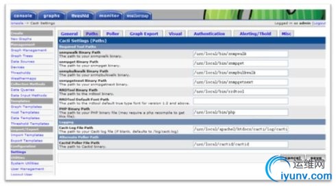

  3).设置cacti用到的命令路径
  snmpwalk Binary Path          /usr/local/ bin/snmpwalk
  snmpget Binary Path         /usr/local/ bin/snmpget
  RRDTool Binary Path         /usr/local/ bin/rrdtool
  PHP Binary Path              /usr/local/bin/php
  Cacti Log File Path          /usr/local/apache/htdocs/cacti/log/cacti.log
  Cactid Poller File Path      /usr/local/cactid/cactid

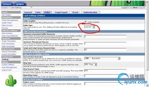

  4).进入cacti后需确认更改以下位置:(如下图)
  Console>Settings>General
  Console>Settings>Poller
