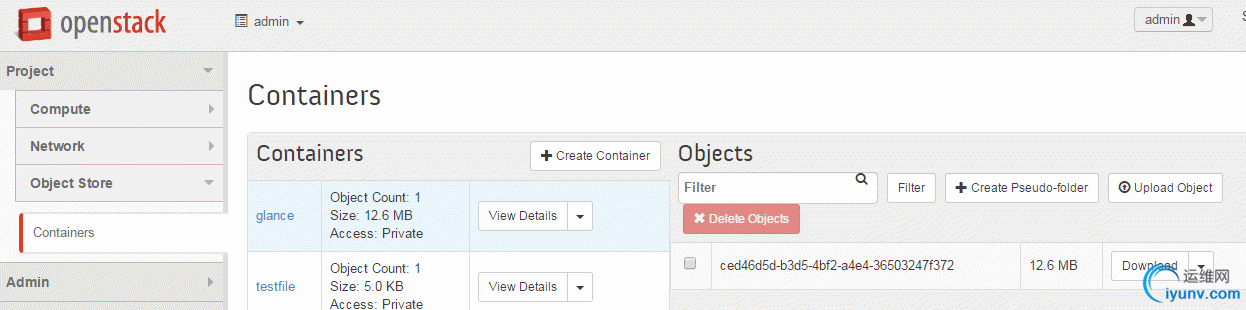

(6)上传文件,查看
#swift upload testfile localfile
#swift list
testfile

systemctl restart openstack-glance-api openstack-glance-registry
# glance image-create --name "cirros-3.3.3-x86_64x1" --file cirros-0.3.3-x86_64-disk.img   --disk-format qcow2 --container-format bare --is-public True --progress
[=============================>] 100%
| Property         | Value                                |
| checksum         | 133eae9fb1c98f45894a4e60d8736619     |
| container_format | bare                                 |
| created_at       | 2015-11-26T02:17:17                  |
| deleted          | False                                |
| deleted_at       | None                                 |
| disk_format      | qcow2                                |
| id               | a6185a87-8291-4053-9ac1-6fb6fe1997f6 |
| is_public        | True                                 |
| min_disk         | 0                                    |
| min_ram          | 0                                    |
| name             | cirros-3.3.3-x86_64x1                |
| owner            | 5cd48f15e3514988870611ab2eeee536     |
| protected        | False                                |

(9)登录openstack dashboard可以查看刚刚上传的情况:
