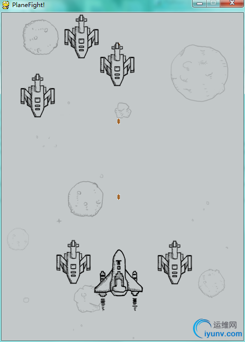

  结果就是这样了:
  子弹完成了以后,飞机还会远么?

# -*- coding: utf8 -*-
background_image_filename = 'background.png'
mouse_image_filename = 'hero.png'
bullet_image_filename = 'bullet.png'
enemy_image_filename = 'enemy.png'
#指定图像文件名称
import pygame #导入pygame库
from sys import exit #向sys模块借一个exit函数用来退出程序
from random import randint #引入随机数
#定义一个Bullet类,封装子弹的数据和方法
class Bullet(object):
def __init__(self):
self.x = 0
self.y = -100
self.speed = 600
self.image = pygame.image.load(bullet_image_filename).convert_alpha()
self.active = False
def move(self, passed_time_second):
if self.y < 0:
self.active = False
else:
self.y -= self.speed*passed_time_second
def restart(self):
self.active = True
mouseX, mouseY = pygame.mouse.get_pos()
self.x = mouseX - self.image.get_width()/2
self.y = mouseY - self.image.get_width()/2
class Enemy(object):#定义一个Enemy类,封装敌机的数据和方法
def restart(self):
self.x = randint(-30,400)
self.y = randint(-100, -50)
self.speed = randint(100,400)
self.active = True
def __init__(self):
self.restart()
self.active = False
self.image = pygame.image.load(enemy_image_filename).convert_alpha()
if self.y < 650:
self.y += self.speed*passed_time_second
else:
self.active = False
pygame.init() #初始化pygame,为使用硬件做准备
screen = pygame.display.set_mode((480, 650), 0, 32)
#创建了一个窗口
pygame.display.set_caption("PlaneFight!")
#设置窗口标题
pygame.mouse.set_visible(False)
background = pygame.image.load(background_image_filename).convert()
mouse_cursor = pygame.image.load(mouse_image_filename).convert_alpha()
#加载并转换图像
bullet = []
for i in range(6):#子弹总数量
    bullet.append(Bullet())
interval_bullet = 25 #发射子弹的帧数间隔
index_bullet = 0 #初始化子弹坐标
enemy = []
for i in range(10):#敌机总数量
    enemy.append(Enemy())
interval_enemy = 100 #敌机出现的间隔
index_enemy = 0 #初始化敌机坐标
clock = pygame.time.Clock()
while True:
#游戏主循环
for event in pygame.event.get():
if event.type == pygame.QUIT:
#接收到退出事件后退出程序
            pygame.quit()
exit()
time_passed = clock.tick(100)
time_passed_second = time_passed/1000.0
screen.blit(background, (0,0))
#将背景图画上去
x, y = pygame.mouse.get_pos()
#获得鼠标位置
interval_bullet -= 1
if interval_bullet <= 0:
bullet[index_bullet].restart()#重置子弹
index_bullet = (index_bullet + 1) % 6 #循环递增
for b in bullet:
if b.active:
b.move(time_passed_second)#移动子弹
screen.blit(b.image, (b.x, b.y))#显示子弹
interval_enemy -= 1
if interval_enemy <= 0:
interval_enemy = randint(30,100)
enemy[index_enemy].restart() #重置飞机
index_enemy = (index_enemy + 1) % 10 #循环递增
for e in enemy:
if e.active:
e.move(time_passed_second) #移动敌机
screen.blit(e.image, (e.x, e.y)) #显示敌机
x-= mouse_cursor.get_width() / 2
y-= mouse_cursor.get_height() / 2
#计算光标的左上角位置
#screen.blit(bullet.image, (bullet.x, bullet.y))
    screen.blit(mouse_cursor, (x, y))
#把各个元素画上去
pygame.display.update()
#刷新一下画面
