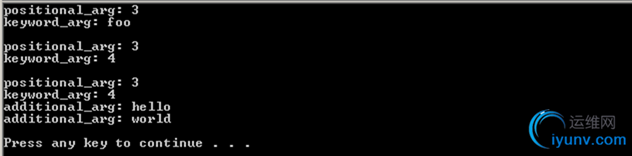

  看一个例子:
def argFunc(positional_arg, keyword_arg="foo", *tuple_grp_nonkw_args):
print "positional_arg:", positional_arg
print "keyword_arg:", keyword_arg
for arg in tuple_grp_nonkw_args:
print "additional_arg:", arg
argFunc(3)
print
argFunc(3, 4)
print
argFunc(3, 4, "hello", "world")
  代码的输出为:

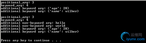

  看一个例子:
def argFunc(positional_arg, keyword_arg="foo", *tuple_grp_nonkw_args, **dict_grp_kw_args):
print "additional non-keyword arg:", arg
for argKey in dict_grp_kw_args.keys():
print "additional keyword arg: {'%s': %s}" %(argKey, dict_grp_kw_args[argKey])
argFunc(3, 4, name="wilber", age=28)
print
argFunc(3, 4, "hello", "world", name="wilber", age=28)
print
  代码输出为:
