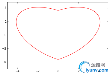

  测试如下代码:
1 import numpy as np
2 import matplotlib.pyplot as plt
4 X = np.arange(-5.0, 5.0, 0.1)
5 Y = np.arange(-5.0, 5.0, 0.1)
7 x, y = np.meshgrid(X, Y)
8 f = 17 * x ** 2 - 16 * np.abs(x) * y + 17 * y ** 2 - 225
9
10 fig = plt.figure()
11 cs = plt.contour(x, y, f, 0, colors = 'r')
12 plt.show()
  运行后:
