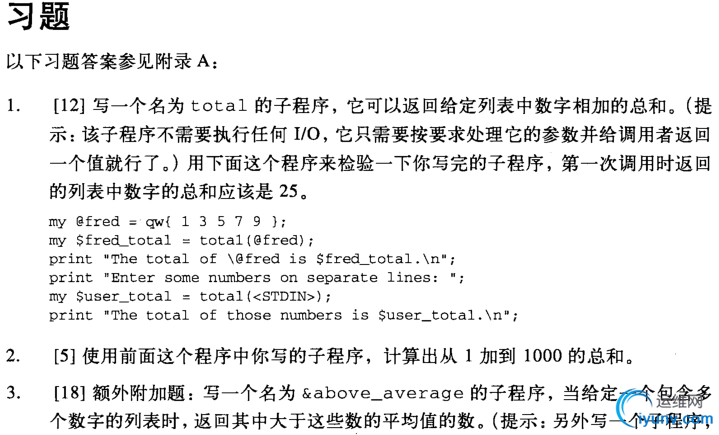

  1. 题目
  2. 代码

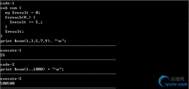

  1 #-----------------------------------------------------------#
  2 # Source: Learning Perl, chapter4
  3 # Date:   2012-01-14
  4 # Author: xiaodongrush
  5 #-----------------------------------------------------------#
  6 #                          code-1                           #
  7 #-----------------------------------------------------------#
  8 $split = "-------------------------------------------------";
  9 $code1 = 'sub sum {'                   . "\n" .
10          '  my $result = 0;'           . "\n" .
11          '  foreach(@_) {'             . "\n" .
12          '    $result += $_;'          . "\n" .
13          '  }'                         . "\n" .
14          '  $result;'                  . "\n" .
15          '}'                           . "\n" .
16          'print &sum(1,3,5,7,9). "\n";';
17 print "code-1\n" . $code1 . "\n" . $split;
18 #-----------------------------------------------------------#
19 #                          execute-1                        #
20 #-----------------------------------------------------------#
21 print "\nexecute-1\n";
22 sub sum {
23   my $result = 0;
24   foreach(@_) {
25     $result += $_;
26   }
27   $result;
28 }
29 print &sum(1,3,5,7,9) . "\n";
30 #-----------------------------------------------------------#
31 #                          code-2                           #
32 #-----------------------------------------------------------#
33 $code2 = 'print &sum(1..1000) + "\n";';
34 print $split . "\ncode-2\n" . $code2 . "\n" . $split;
35 #-----------------------------------------------------------#
36 #                          execute-2                        #
37 #-----------------------------------------------------------#
38 print "\nexecute-2\n";
39 print &sum(1..1000) . "\n";
