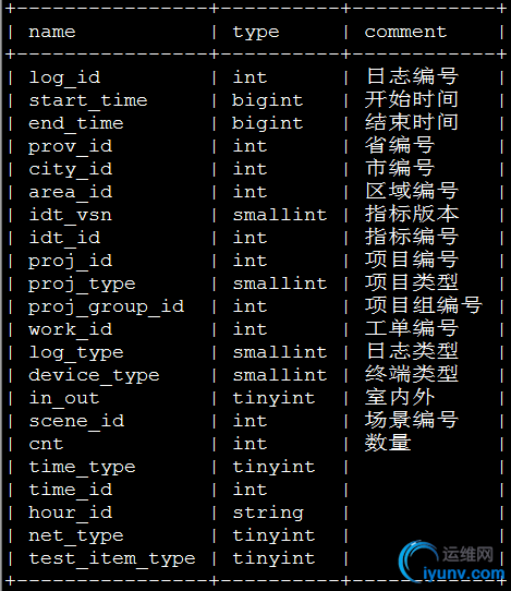

用来示例的表结构设计,如图所示:
下面,我们通过给出一些SQL查询统计语句,然后对应翻译成Solr查询语句,然后对比结果

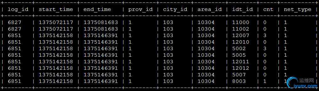

查询对比
条件组合查询
SQL查询语句:
  • SELECT log_id,start_time,end_time,prov_id,city_id,area_id,idt_id,cnt,net_type
  • FROM v_i_event
  • WHERE prov_id = 1 AND net_type = 1 AND area_id = 10304 AND time_type = 1 AND time_id >= 20130801 AND time_id <= 20130815
  • ORDER BY log_id LIMIT 10;
复制代码
查询结果,如图所示:
Solr查询URL:
  •         http://slave1:8888/solr-cloud/i_event/select?q=*:*&fl=log_id,start_time,end_time,prov_id,city_id,area_id,idt_id,cnt,net_type&fq=prov_id:1 AND net_type:1 AND area_id:10304 AND time_type:1 AND time_id:[20130801 TO 20130815]&sort=log_id asc&start=0&rows=10
复制代码
查询结果,如下所示:

复制代码
对比上面结果,除了根据idt_id排序方式不同以外(Impala是升序,Solr是降序),其他是相同的。

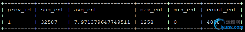

单个字段分组统计
SQL查询语句:
  • SELECT prov_id, SUM(cnt) AS sum_cnt, AVG(cnt) AS avg_cnt, MAX(cnt) AS max_cnt, MIN(cnt) AS min_cnt, COUNT(cnt) AS count_cnt
  • FROM v_i_event
  • GROUP BY prov_id;
复制代码
查询结果,如图所示:
Solr查询URL:
  • http://slave1:8888/solr-cloud/i_event/select?q=*:*&stats=true&stats.field=cnt&rows=0&indent=true
复制代码
查询结果,如下所示:

  • </response>
复制代码
对比查询结果,Solr提供了更多的统计项,如标准差(stddev)等,与SQL查询结果是一致的。

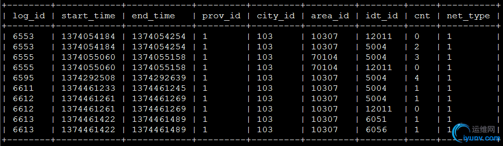

IN条件查询
SQL查询语句:
[cde lang="sql"]
FROM v_i_event
WHERE prov_id = 1 AND net_type = 1 ANDcity_id IN(106,103) AND idt_id IN(12011,5004,6051,6056,8002) AND time_type = 1AND time_id >= 20130801 AND time_id <= 20130815
ORDER BY log_id, start_time DESC LIMIT 10;
[/code]
查询结果,如图所示:
Solr查询URL:
  • http://slave1:8888/solr-cloud/i_event/select?q=*:*&fl=log_id,start_time,end_time,prov_id,city_id,area_id,idt_id, cnt,net_type&fq=prov_id:1 AND net_type:1 AND (city_id:106 OR city_id:103) AND (idt_id:12011 OR idt_id:5004 OR idt_id:6051 OR idt_id:6056 OR idt_id:8002) AND time_type:1 AND time_id:[20130801 TO 20130815]&sort=log_id asc ,start_time desc&start=0&rows=10
复制代码
  • http://slave1:8888/solr-cloud/i_event/select?q=*:*&fl=log_id,start_time,end_time,prov_id,city_id,area_id,idt_id, cnt ,net_type&fq=prov_id:1&fq=net_type:1&fq=(city_id:106 OR city_id:103)&fq=(idt_id:12011 OR idt_id:5004 OR idt_id:6051 OR idt_id:6056 OR idt_id:8002)&fq=time_type:1&fq=time_id:[20130801 TO 20130815]&sort=log_id asc,start_time desc&start=0&rows=10
复制代码
查询结果,如下所示:

复制代码
对比查询结果,是一致的。

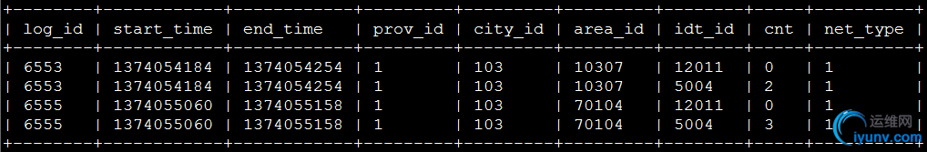

开区间范围条件查询
SQL查询语句:
SELECTlog_id,start_time,end_time,prov_id,city_id,area_id,idt_id,cnt,net_type
FROM v_i_event
WHERE net_type = 1 AND idt_idIN(12011,5004,6051,6056,8002) AND time_type = 1 AND start_time >= 1373598465AND end_time < 1374055254
ORDER BY log_id, start_time, idt_id DESCLIMIT 30;
查询结果,如图所示:
Solr查询URL:
  • http://slave1:8888/solr-cloud/i_event/select?q=*:*&fl=log_id,start_time,end_time,prov_id,city_id,area_id,idt_id,cnt,net_type&fq=net_type:1 AND (idt_id:12011 OR idt_id:5004 OR idt_id:6051 OR idt_id:6056 OR idt_id:8002) AND time_type:1 AND start_time:[1373598465 TO 1374055254]&fq =-start_time:1374055254&sort=log_id asc,start_time asc,idt_id desc&start=0&rows=30
复制代码
  • http://slave1:8888/solr-cloud/i_event/select?q=*:*&fl=log_id,start_time,end_time,prov_id,city_id,area_id,idt_id,cnt,net_type&fq=net_type:1 AND (idt_id:12011 OR idt_id:5004 OR idt_id:6051 OR idt_id:6056 OR idt_id:8002) AND time_type:1 AND start_time:[1373598465 TO 1374055254] AND -start_time:1374055254&sort=log_id asc,start_time asc,idt_id desc&start=0&rows=30
复制代码
  • http://slave1:8888/solr-cloud/i_event/select?q=*:*&fl=log_id,start_time,end_time,prov_id,city_id,area_id,idt_id,cnt,net_type&fq=net_type:1&fq=idt_id:12011 OR idt_id:5004 OR idt_id:6051 OR idt_id:6056 OR idt_id:8002&fq =time_type:1&fq=start_time:[1373598465 TO 1374055254]&fq =-start_time:1374055254&sort=log_id asc,start_time asc,idt_id desc&start=0&rows=30
复制代码
查询结果,如下所示:

  • </result>
  • </response>
复制代码

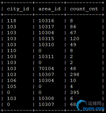

多个字段分组统计(只支持count函数)
SQL查询语句:
SELECT city_id, area_id, COUNT(cnt) AScount_cnt
FROM v_i_event
GROUP BY city_id, area_id;
查询结果,如图所示:
Solr查询URL:
  • http://slave1:8888/solr-cloud/i_event/select?q=*:*&facet=true&facet.pivot=city_id,area_id&fq=prov_id:1 AND net_type:1&rows=0&indent=true
复制代码
对比上面结果,Solr查询结果,需要从上面的各组中进行合并,得到最终的统计结果,结果和SQL结果是一致的。

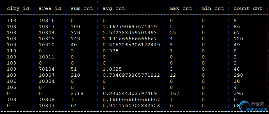

多个字段分组统计(支持count、sum、max、min等函数)
一次对多个字段进行独立分组统计,Solr可以很好的支持。这相当于执行两个带有GROUP BY子句的SQL,这两个GROUP BY分别只对一个字段进行汇总统计。
SQL查询语句:
  • SELECT city_id, area_id, COUNT(cnt) AS count_cnt
  • FROM v_i_event
  • GROUP BY city_id;
  • FROM v_i_event
  • GROUP BY area_id;
复制代码
查询结果,不再显示。
Solr查询URL:
  • >http://slave1:8888/solr-cloud/i_event/select?q=*:*&stats=true&stats.field=cnt&f.cnt.stats.facet=city_id&&f.cnt.stats.facet=area_id&fq=prov_id:1 AND net_type:1&rows=0&indent=true
复制代码
查询结果,如下所示:

SELECT city_id, area_id, SUM(cnt) ASsum_cnt, AVG(cnt) AS avg_cnt, MAX(cnt) AS max_cnt, MIN(cnt) AS min_cnt,COUNT(cnt) AS count_cnt
FROM v_i_event
查询结果,如图所示:
