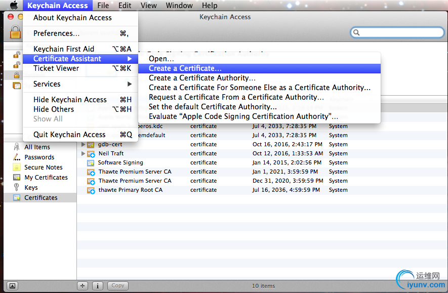

  Open up the Keychain Access application (/Applications/Utilities/Keychain Access.app). Navigate via the menu to Keychain Access > Certificate Assistant > Create Certificate...

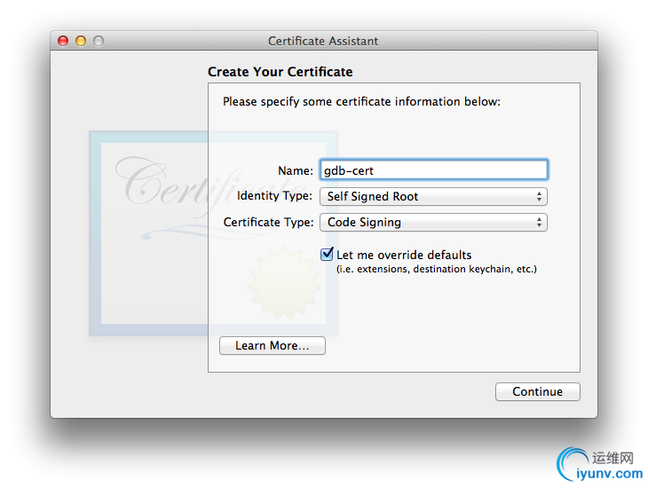

  Enter a name for the certificate. For this how-to, I'll call it "gdb-cert". Set the fields exactly as shown below.
  The maximum validity period is 999 days. I don't really want to deal with this again, so I'm going to max it out.

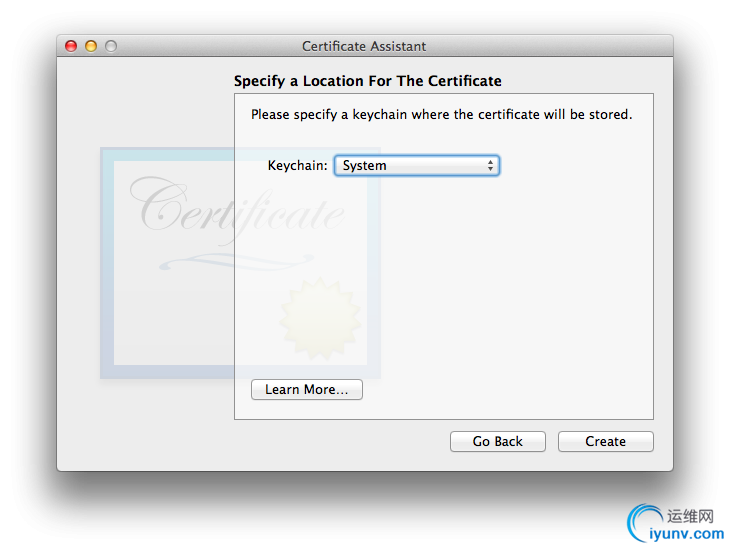

  Keep clicking the "Continue" button until you are asked for a location. Set it to "System".3

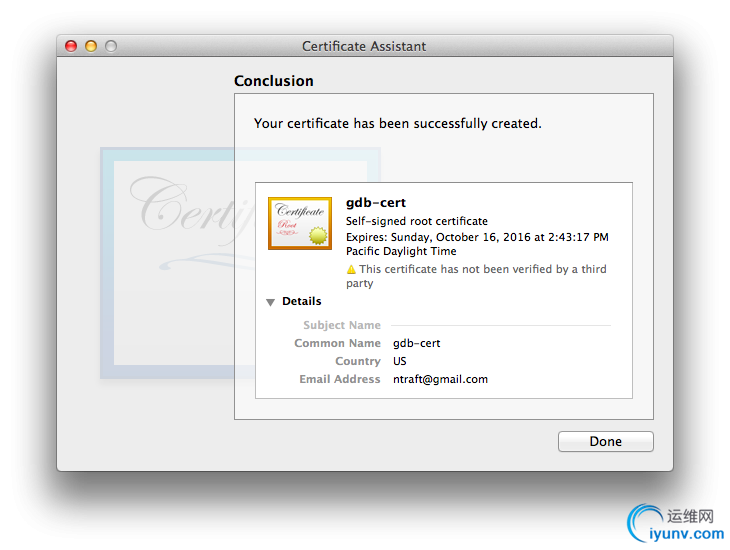

  Success!
