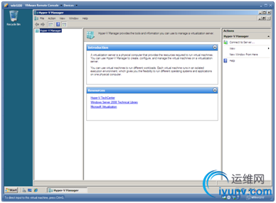

  • After the restart, click Start, click Administrative Tools, and then click Hyper-V Manager.
  • In the left pane of the MMC, click Hyper-V Manager.
  • In the Actions menu, click Connect to Server, clickAnother Computer, and then type the name or IP address of the server that you want to connect to.
  Screen shot of the Server Manager Add Features Wizard where you choose to install the Hyper-V Tools.
  Then after the reboot you are able to open the Hyper-V Manager and then add your Hyper-V Server 2008 for remote management.

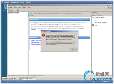

  Unfortunately, I received the following error when attempting to connect to my Hyper-V Server 2008.
  The problem occurs because Server 2008 and Hyper-V Server are in a workgroup and not a domain. The error I received contains “check that the virtual machine management service is running and that you are authorized to connect to the server.”

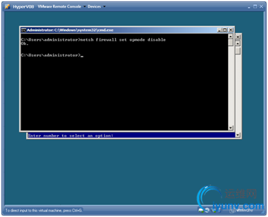

  Since I was tired of making configuration changes, in a lab setting, and lazy I just disabled the Hyper-V Server 2008 Firewall using a console command I found at http://www.realtime-windowsserver.com/tips_tricks/2007/08/server_2008_core_crib_sheet.htm.
  “Disable the firewall (at least until everything is working):
netsh firewall set opmode disable
  I also found some info about remotely managing a Windows 2008 Server Core firewall at http://www.petri.co.il/remotely-managing-windows-2008-server-core-firewall.htm.
  Finally I was able to connect with the Hyper-V Manager and build a VM.
