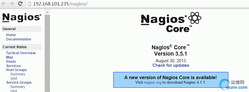

启动服务:
[iyunv@server ~]# service httpd start; service nagios start
浏览器访问: http://192.168.101.235/nagios

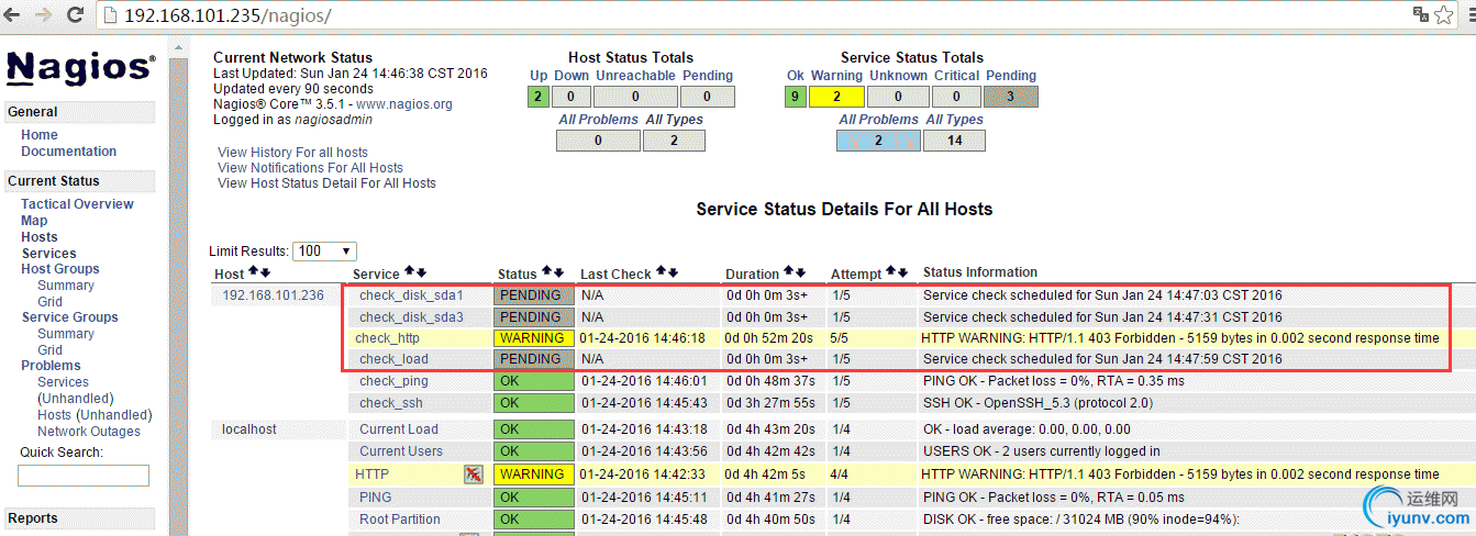

检查配置文件是否有错误:
[iyunv@server ~]# nagios -v /etc/nagios/nagios.cfg
Total Warnings: 0
Total Errors:   0
[iyunv@server conf.d]# service httpd restart; service nagios restart
发现http服务critical,可能是80端口没有启动,client上启动httpd服务即可。
