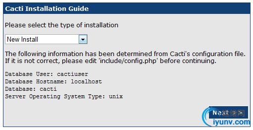

正常之后,在浏览器输入http://ip/cacti会出现如下界面:

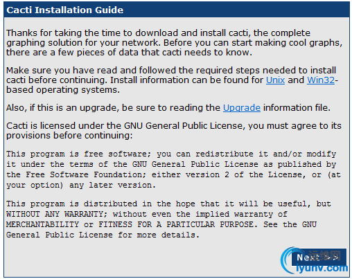

这一步直接next,然后会出现如下界面:
因为我们是第一次安装,所以选择新安装,然后next:出现如下界面:

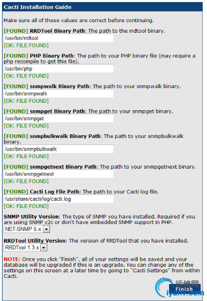

这一步我们看见各种文件的位置,若是全部显示Found,则可以直接点击finish,若不是可以自己找到合适的位置,一般都是默认即可!下一步:

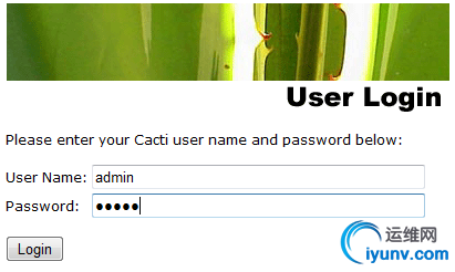

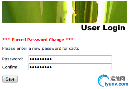

输入帐号和密码,都为admin,默认的,然后下一步会强制修改密码:

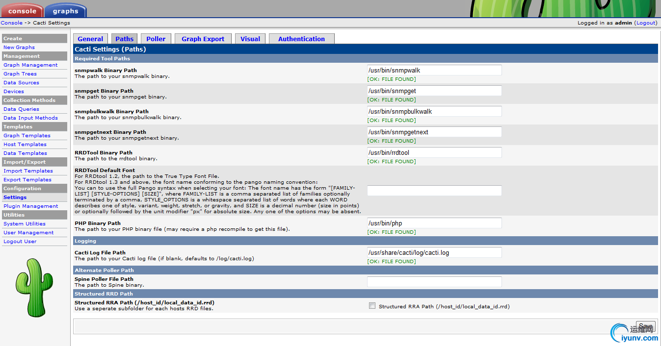

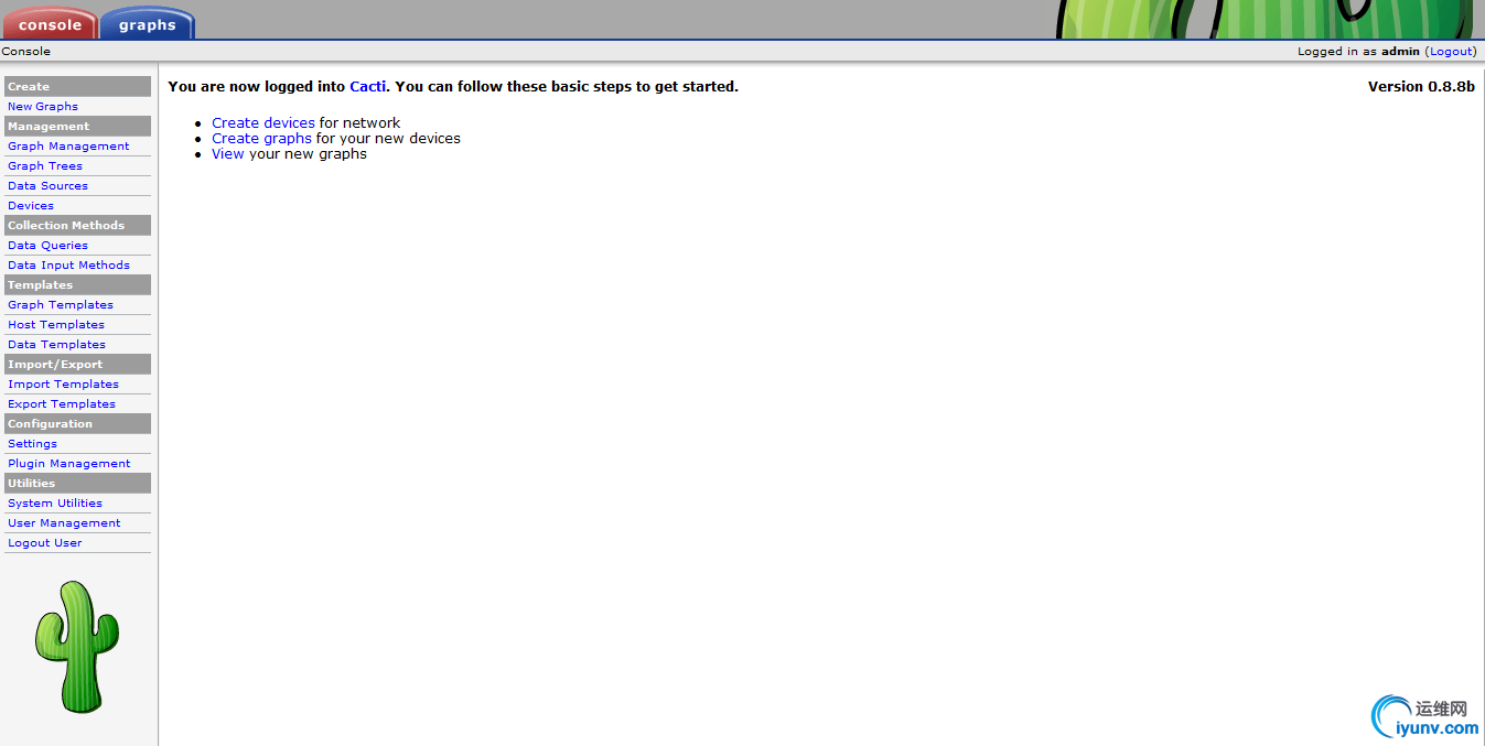

点击左边的settings----path打开控制台,如下图:

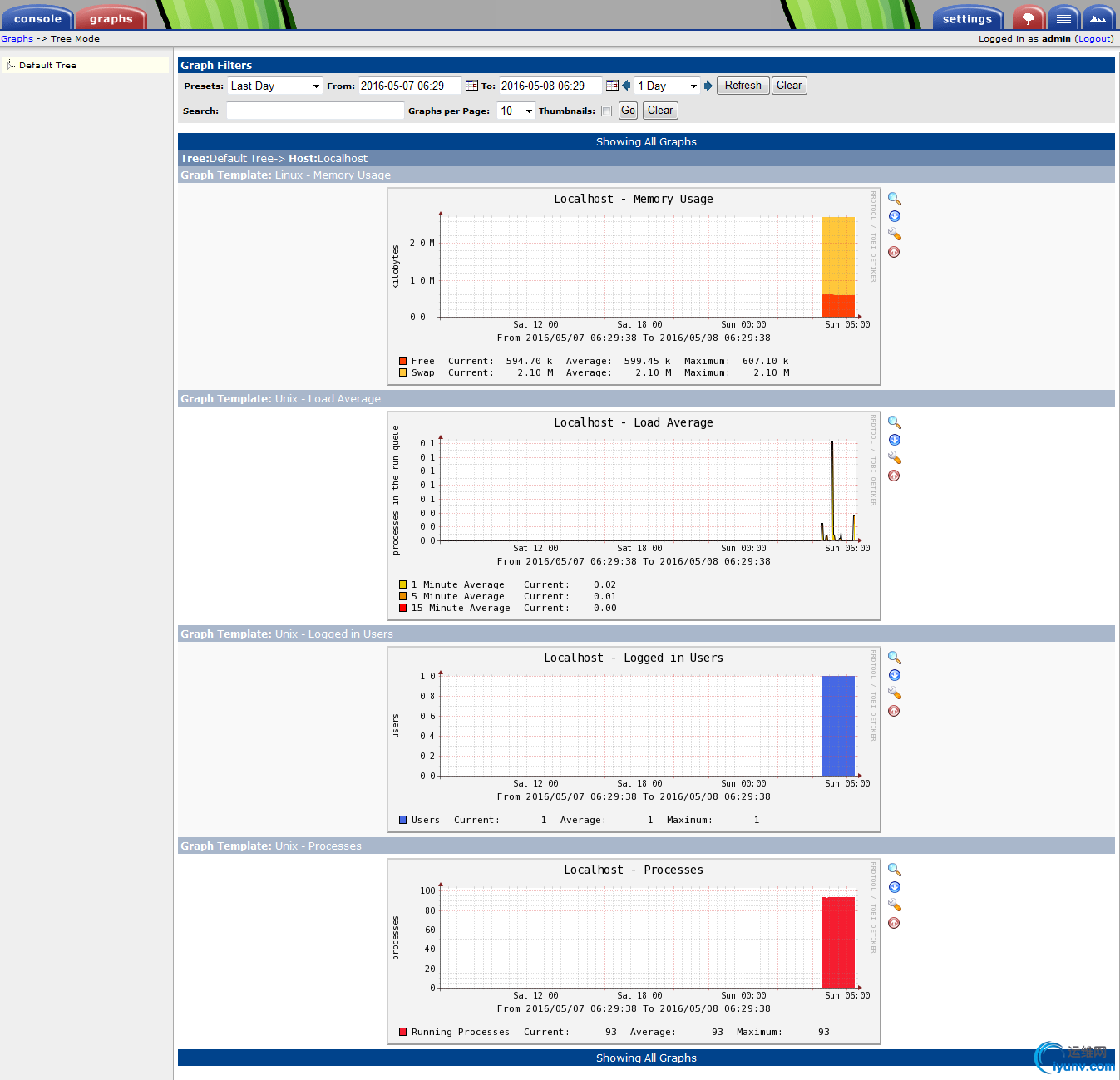

wKioL1ct-9_wOWM2AADuerba49s316.jpg 点击graps进入监控系统界面,发现并没有图形如下图:

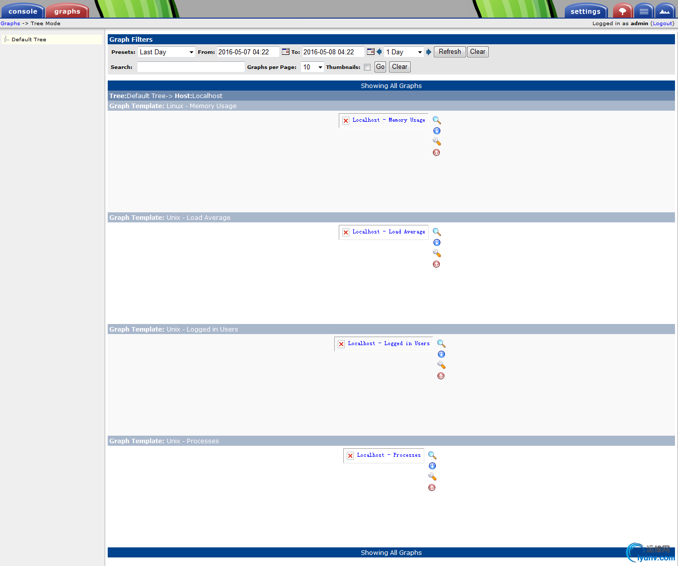

wKioL1ct_CqiPdqxAACrdVlFmk8321.jpg 这时候我们运行如下命令生成图形:
[iyunv@lvs ~]# /usr/bin/php /usr/share/cacti/poller.php
PHP Warning:  strtotime(): It is not safe to rely on the system's timezone settings. You are *required* to use the date.timezone setting or the date_default_timezone_set() function. In case you used any of those methods and you are still getting this warning, you most likely misspelled the timezone identifier. We selected 'Asia/Chongqing' for 'CST/8.0/no DST' instead in /usr/share/cacti/include/global_constants.php on line 165
PHP Warning:  date(): It is not safe to rely on the system's timezone settings. You are *required* to use the date.timezone setting or the date_default_timezone_set() function. In case you used any of those methods and you are still getting this warning, you most likely misspelled the timezone identifier. We selected 'Asia/Chongqing' for 'CST/8.0/no DST' instead in /usr/share/cacti/include/global_constants.php on line 165
tifier. We selected 'Asia/Chongqing' for 'CST/8.0/no DST' instead in /usr/share/cacti/include/global_constants.php on line 166
·······/过程很长,结束时我们可以查看一下命令返回值!
[iyunv@lvs ~]# echo $?
0                          /返回数字“0”说明,命令运行结果正确

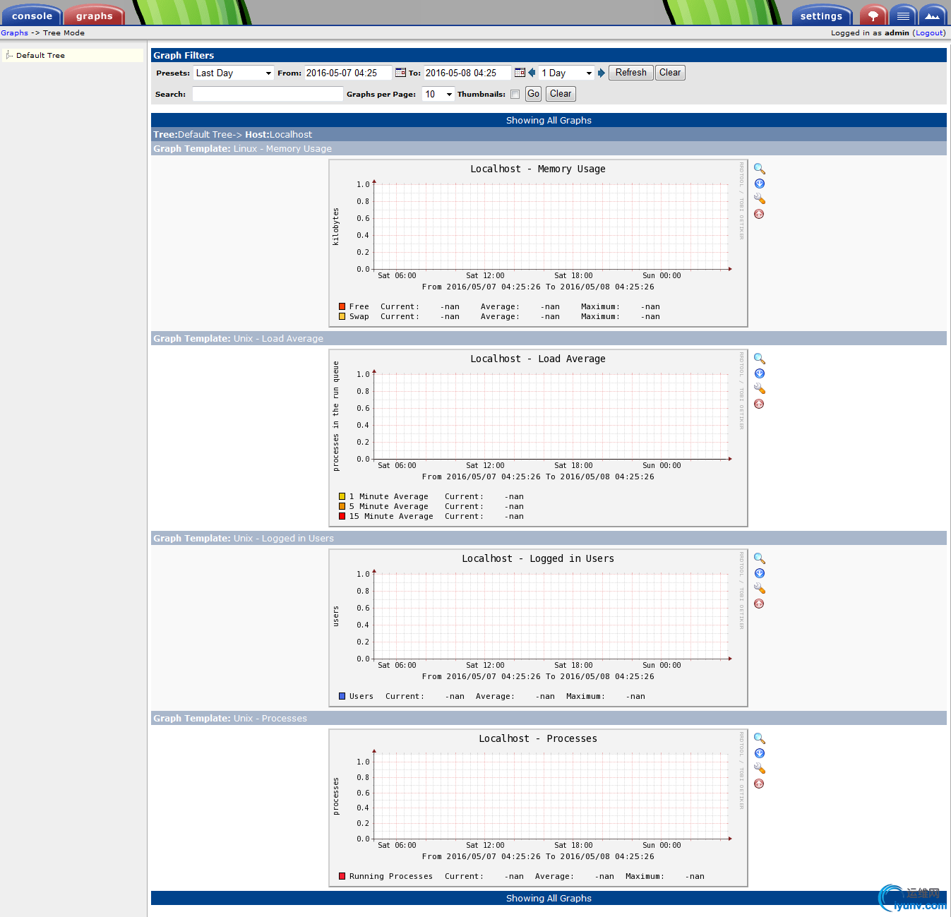

这时候在查看一下监控图像会发现如下图:
会发现已经出现了坐标,但是没有图像;我们刚才运行的命令,写入计划任务:
[iyunv@lvs ~]# crontab -e
no crontab for root - using an empty one
crontab: installing new crontab
[iyunv@lvs ~]# crontab -l
*/5 * * * * /usr/bin/php /usr/share/cacti/poller.php > /dev/null 2>&1
过一段时间之后会发现已经出现图形如下:因为自己的模拟机负载不是很高,这一段时间会挺长的!
