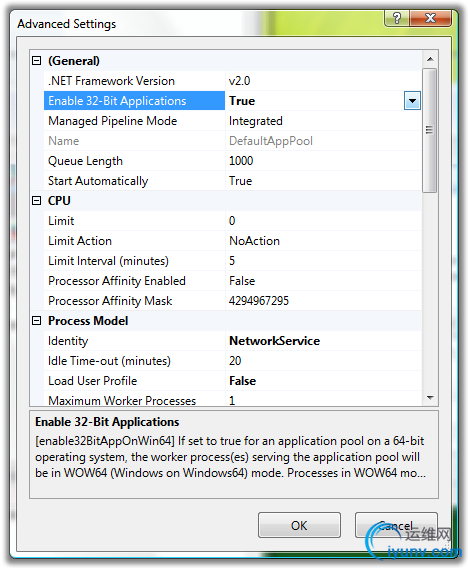

    Additionaly, you will have to set the folder permissions to allow iis_iusrs to connect to the databse from a client pc
  • 2.Abhishek Browne | November 22nd, 2008 at 3:18 pm
    I am using Vista 64 bit. Second soln. worked for me
  • 3.Paul | December 4th, 2008 at 7:55 pm
    Can you tell me how to navigate to those screens to set the Enable 32-Bits Applications to True on a windows Vista OS?
  • 4.Renaud| December 8th, 2008 at 3:02 pm
    @Paul: you should be able to access IIS configuration settings by right-clicking on My Computer and choosingManageto open theComputer Managementconsole.
    From there, IIS settings are accessible under theServices and Applicationstree.

    One issue with this is that you lock IIS into running only 32-bit code.
  • 10.Renaud| March 9th, 2009 at 10:03 am
    @TheArtTrooper: true, but I don’t think you can have it both ways: if you need Jet, you’re stuck with 32 bits.
  • 11.Sean | March 17th, 2009 at 1:17 am

    Be sure the the IIS feature is turned on…to do that go to control panel -> turn windows features on or off, then check the internet information services box
