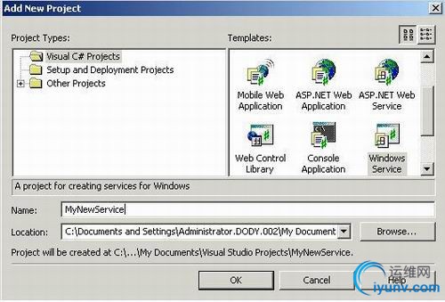

Using the code
  At first you should simply open VS.NET and then at the File menu click on New, Project. From the New Project Dialog Box, choose the Windows service template project and name it MyNewService like shown below:
  The project template automatically adds a component class that is called Service1 by default and inherits from System.ServiceProcess.ServiceBase.
  Click the designer. Then, in the Properties window, set the ServiceName property for Service1 to MyNewService.
  Set the Name property to MyNewService. Set the AutoLog property to true.
  In the code editor, edit the Main method to create an instance of MyNewService. When you renamed the service in step 3, the class name was not modified in the Main method. To access the Main method in VC#, expand the Component Designer generated code region.

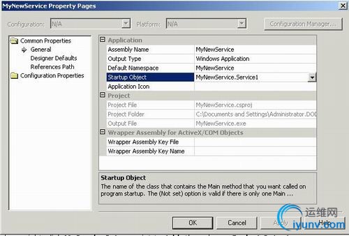

To build your service project
  • In Solution Explorer, right-click your project and select Properties from the shortcut menu. The project's Property Pages dialog box appears.
  • In the left pane, select the General tab in the Common Properties folder.
  • From the Startup object list, choose MyNewService. Click OK.
  • Press Ctrl+Shift+B to build the project.

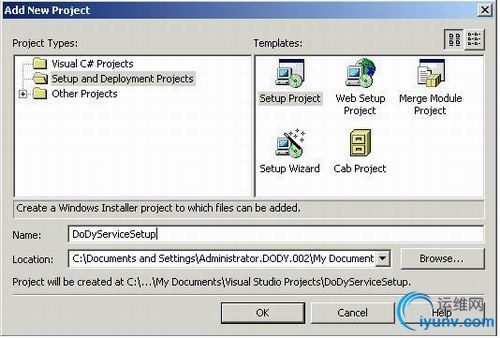

  Now that the project is built, it can be deployed. A setup project will install the compiled project files and run the installers needed to run the Windows service. To create a complete setup project, you will need to add the project output, MyNewService.exe, to the setup project and then add a custom action to have MyNewService.exe installed.
To create a setup project for your service
  • On the File menu, point to Add Project, and then choose New Project.
  • In the Project Types pane, select the Setup and Deployment Projects folder.
  • In the Templates pane, select Setup Project. Name the project MyServiceSetup.

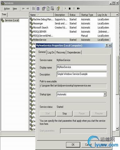

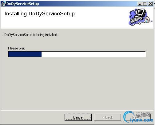

To install the Windows Service
  Browse to the directory where the setup project was saved, and run the .msi file to install MyNewService.exe.
To start and stop your service
  • Open the Services Control Manager by doing one of the following:
    • In Windows 2000 Professional, right-click My Computer on the desktop, then click Manage. In the Computer Management console, expand the Services and Applications node.  -Or-
    • In Windows 2000 Server, click Start, point to Programs, click Administrative Tools, and then click Services.  Note:In Windows NT version 4.0, you can open this dialog box from Control Panel.
  • You should now see MyNewService listed in the Services section of the window.
  • Select your service in the list, right-click it, and then click Start.
  Right-click the service, and then click Stop.

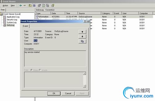

To verify the event log output of your service
  • Open Server Explorer and access the Event Logs node. For more information, see Working with Event Logs in Server Explorer.  Note:The Servers node of Server Explorer is not available in the Standard Edition of Visual Basic and Visual C# .NET.
