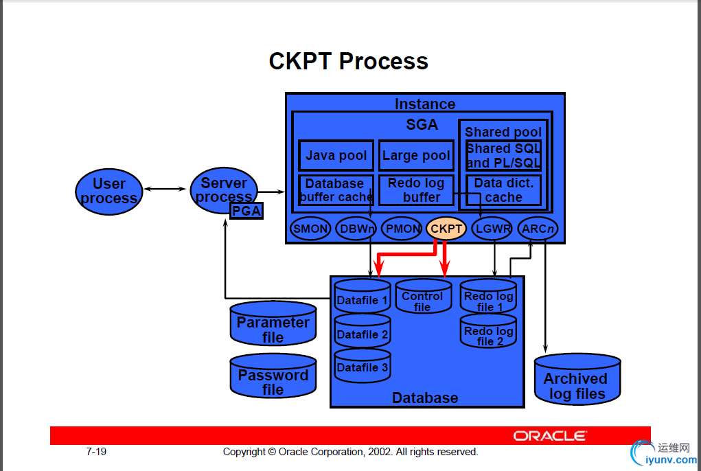

  1、Checkpoint Process (CKPT):
  The checkpoint process (CKPT) is responsible for signaling DBWn at checkpoints and updating the datafiles and control files of the database to indicate the most recent checkpoint.
  Every three seconds, CKPT records the RBA from the oldest entry in the checkpoint queue in the control file. This RBA represents the point in the redo log at which instance recovery is to begin after an instance failure. It can do this because all of the data blocks represented in prior redo records are guaranteed to have been written to disk by DBWn.
Only in the event of a log switch, does CKPT also write this information to the headers of the datafiles. To improve performance not all of the headers are written at once, but rather they are updated in groups in what is referred to as a “lazy write.” Log switches do not force all dirty buffers to be written to disk.
