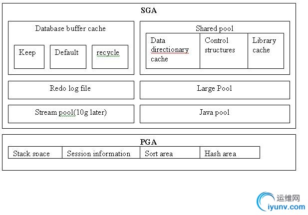

  The illustration show the different composing between SGA and PGA.
