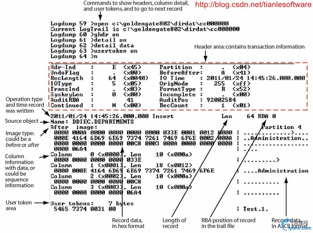

  我们可以通过GG 自带的logdump 工具来查看trails 文件的具体格式。
2.1 logdump 工具使用说明
  MOS 上有关logdump的2篇文档:
  How To Save A Part Of A GoldenGate Trail ToA New Trail [ID 966188.1]
  Oracle GoldenGate - Using the GoldenGateLogdump Utility to Manually Load Balance across Multiple Processes [ID1301300.1]
  2.1.1 进入GG 安装目录,运行logdump命令。

  2.1.2 set up the view –建立logdump环境
  (1)To view the record header with thedata:
  Logdump 1 >ghdr on
  (2)To add column information
  Logdump 2 >detail on
  -- Column informationincludes the number and length in hex and ASCII.
  (3)To add hex and ASCII data values to the column information:
  Logdump 3 >detail data
  (4)To view user tokens:
  Logdump 4 >usertoken on
  (5)To control how much record data is displayed:
  Logdump 5> RECLEN <length>
  Logdump 5 >reclen 1000
  Reclen set to 1000
  2.1.3 To open a trail file 打开文件
  (1)指定trail 文件
  Logdump 6 >open /u01/ggate/dirdat/lt000008
  Current LogTrail is/u01/ggate/dirdat/lt000008
  (2)To go to the first record and thenmove through records in sequence:
  Logdump 7>NEXTor N
  示例:
  Logdump 7 >n
  ___________________________________________________________________
  Hdr-Ind: E (x45)Partition : .(x04)
  UndoFlag: . (x00)BeforeAfter: A (x41)
  RecLength: 45 (x002d)IO Time : 2011/11/1713:11:28.000.000
  IOType: 5 (x05)OrigNode : 255(xff)
  TransInd: . (x00)FormatType : R (x52)
  SyskeyLen: 0 (x00)Incomplete : . (x00)
  AuditRBA: 23 AuditPos : 16783888
  Continued: N (x00)RecCount : 1(x01)
  2011/11/17 13:11:28.000.000 Insert Len 45 RBA 1009
  AfterImage:Partition 4 G b
  00000006 0000 0002 424c 0001 0006 0000 0002 3839 | ........BL........89
  00020015 0000 3230 3131 2d31 312d 3137 3a31 333a | ......2011-11-17:13:
  30393a32 34| 09:24
  Column0 (x0000), Len 6 (x0006)
  00000002 424c| ....BL
  Column1 (x0001), Len 6 (x0006)
  00000002 3839| ....89
  Column2 (x0002), Len 21 (x0015)
  00003230 3131 2d31 312d 3137 3a31 333a 3039 3a32 | ..2011-11-17:13:09:2
  34| 4

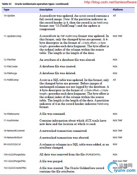

2.2 Trails 格式说明
  这个是官方文档上的一个图。我们现在来看一下,

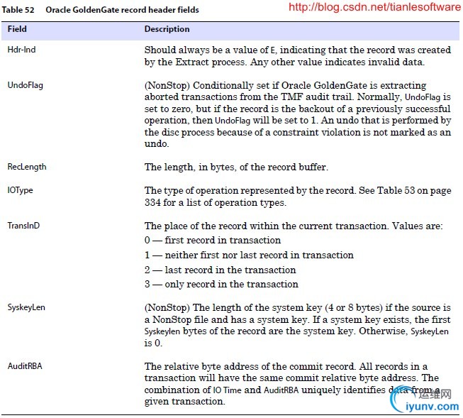

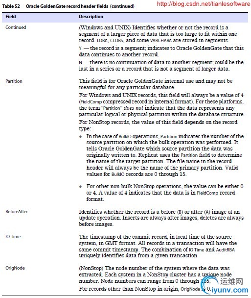

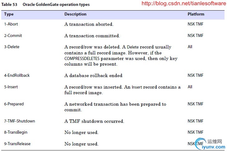

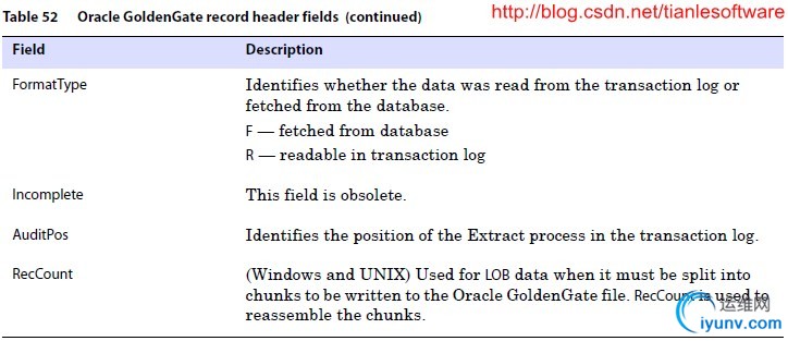

2.2.1 Record header area
  The OracleGoldenGate record header provides metadata of the data that is contained in therecord and includes the following information.
  --GG record header 包含以下内容:
  (1)The operation type, such as aninsert, update, or delete
  (2)The before or after indicatorfor updates
  (3)Transaction information, suchas the transaction group and commit timestamp
  2.2.1.1 Description of header fields
  The following describes the fields of the Oracle GoldenGate record header. Some fields applyonly to certain platforms.

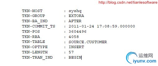

  2.2.1.2 Using header data
  Some of the dataavailable in the Oracle GoldenGate record header can be used for mapping byusing the GGHEADER option of the @GETENV function or by using any of the followingtransaction elements as the source expression in a COLMAP statement in the TABLEor MAP parameter.
  (1)GGS_TRANS_TIMESTAMP
  (2)GGS_TRANS_RBA
  (3)GGS_OP_TYPE
  (4)GGS_BEFORE_AFTER_IND

  Trail 的data area 记录了如下内容:
  (1)The time that the change waswritten to the Oracle GoldenGate file
  (2)The type of database operation
  (3)The length of the record
  (4)The relative byte addresswithin the trail file
  (5)The table name
  (6)The data changes in hex format

2.2.2.3 Tokens area
  The trail recordalso can contain two areas for tokens. One is for internal use and is not documentedhere, and the other is the user tokens area. User tokens are environment valuesthat are captured and stored in the trail record for replication to targetcolumns or other purposes. If used, these tokens follow the data portion of therecord and appear similar to the following when viewed with Logdump:
  --trail record 的token 包含2个areas,其中一个供内部使用,文档就不做说明,另一个是user token。

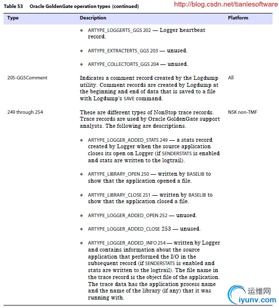

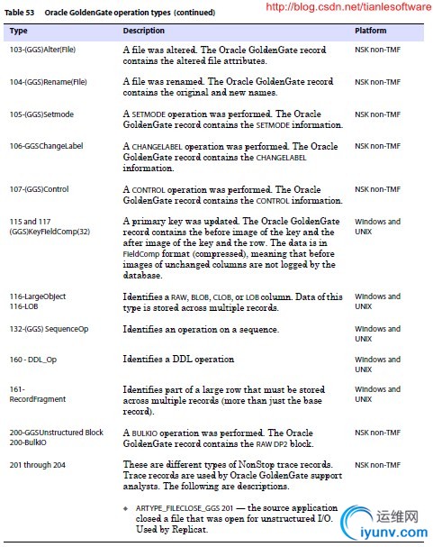

2.2.2.4 Oracle GoldenGate operation types
  The followingare some of the Oracle GoldenGate operation types. Types may be added as newfunctionality is added to Oracle GoldenGate. For a more updated list, use the SHOWRECTYPE command in the Logdump utility.
2.2.3 Oracle GoldenGate trail header record
  In addition tothe transaction-related records that are in the Oracle GoldenGate trail, each trailfile contains a file header.
  --在每个trail file中除了之前讲的trail header,trailarea,还有一个file header。
  The file headeris stored as a record at the beginning of a trail file preceding the data records.The information that is stored in the trail header provides enough information aboutthe records to enable an Oracle GoldenGate process to determine whether the recordsare in a format that the current version of Oracle GoldenGate supports.
  The trail headerfields are stored as tokens, where the token format remains the same across allversions of Oracle GoldenGate. If a version of Oracle GoldenGate does not supportany given token, that token is ignored. Depracated tokens are assigned a defaultvalue to preserve compatibility with previous versions of Oracle GoldenGate.
  You can view thetrail header with the FILEHEADER command in the Logdump utility.
