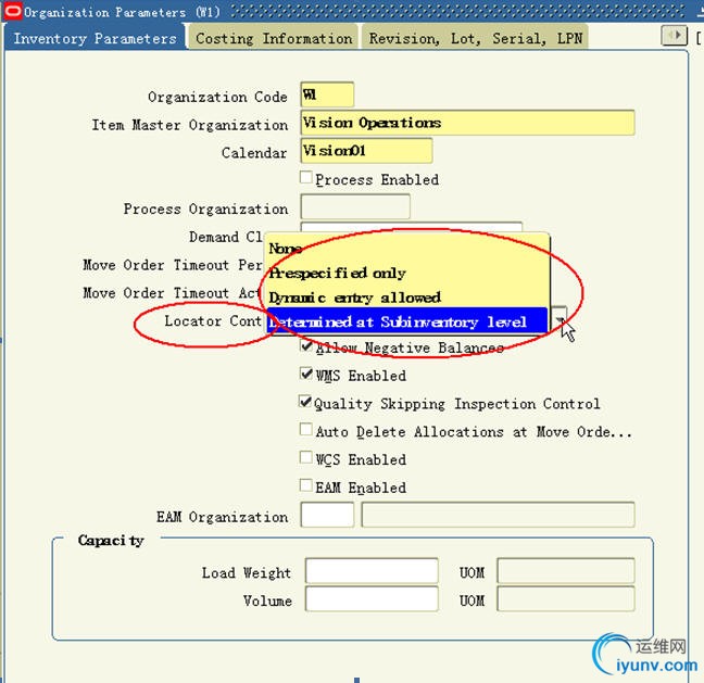

  Locator Level是一个自上而下控制的,Order:Org locator Control > Subinv locator Control > Item locator Control
Org Level Locator Control
  None: Inventorytransactions within this organization do not require locator
  information.
  Prespecified only: Inventory transactions within this organization require a valid,
  predefinedlocator for each item.
  Dynamic entry allowed: Inventory transactions within this organization require a
  locator for eachitem. You can choose a valid, predefined locator, or define a locator
  dynamically atthe time of transaction.
  Determined at subinventory level: Inventory transactions use locator control
  information you define at the subinventory level.

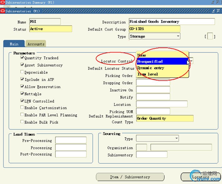

Subinventory Locator Control
  You can select an option only if you selected locatorcontrol as Determined at
  subinventorylevel in the LocatorControl field in the Organization Parameters
  window. You can only update this option if there is noon-hand quantity for the
  subinventory.
  None: Inventorytransactions within this subinventory do not require locator
  information.
  Prespecified: Inventorytransactions within this subinventory require you to enter a
  valid predefinedlocator for each item.
  Dynamic entry: Inventory transactions within this subinventory require you to enter
  a locator foreach item. You may choose a valid predefined locator, or define a
  locatordynamically at the time of transaction.

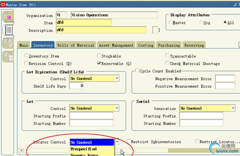

  Item level: Inventorytransactions use locator control information that you define at
  the item level.
Item Level Locator Control
