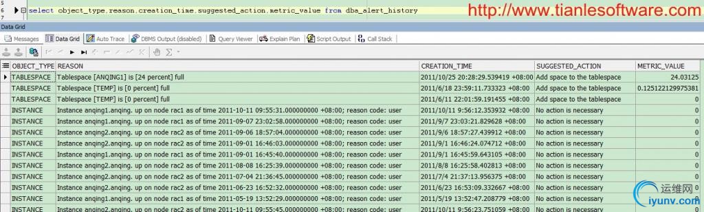

  示例:
  select object_type,reason,creation_time,suggested_action,metric_value from dba_alert_history
