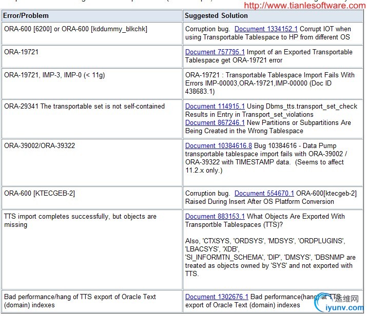

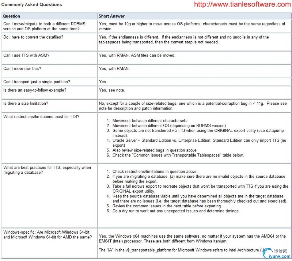

三.TTS 常见问题
  MOS:
  Master Note for Transportable Tablespaces(TTS) -- Common Questions and Issues [ID 1166564.1]
3.1 Commonly Asked Questions
3.2 Common Issues with Transportable Tablespaces
  Please note thisis not an exhaustive list of issues. Please check the "TransportableTablespaces" heading in the "List of Bugs Fixed by Problem Type"notes for the patch set or version above the one you are currently running.These notes have the most comprehensive list of bug fixes in each patch set.

小结:
  (1)源和目标数据库的COMPATIBLE初始化参数必须>=8.1,且必须是企业版
  (2)如果被传输的表空间的block size和目标库的标准块size不一样,那么目标库的COMPATIBLE必须>=9.0
  (3)从Oracle 8i开始,TTS就可以向后跨版本(比如8i-->9i)
  (4)从Oracle 10g开始,TTS可以跨平台,如果源和目标的平台字节序(endianness)相同就不需要额外的步骤,否则还需要进行字节序转换
  (5)源和目标数据库必须具有相同的character set andnational character set.
  (6)TTS支持RAW device file system.
  (7)10g前如果目标库存在同名的表空间,则不能TTS,从10g(COMPATIBLE>=10.0.0)开始,借助tablespace rename特性可以解决这一问题
