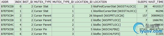

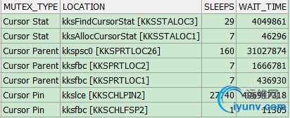

  三.几个与mutex相关的视图
  在第一部分,提到了x$mutex_sleep和x$mutex_sleep_history。我们在联机文档里看不到相关的说明。
  不过可以查看到v$mutex_sleep和v$mutex_sleep_history的说明。但是v$比x$字典显示的列要少。
  select*fromx$mutex_sleep;
  select*fromv$mutex_sleep;
  SYS@anqing2(rac2)> desc x$mutex_sleep_history
  NameNull?Type
  ADDRRAW(4)
  INDXNUMBER
  INST_IDNUMBER
  MUTEX_ADDRRAW(4)
  MUTEX_IDENTIFIERNUMBER
  SLEEP_TIMESTAMPTIMESTAMP(6)
  MUTEX_TYPEVARCHAR2(32)
  MUTEX_TYPE_IDNUMBER
  GETSNUMBER
  SLEEPSNUMBER
  REQUESTING_SESSIONNUMBER
  BLOCKING_SESSIONNUMBER
  LOCATION_IDNUMBER
  LOCATIONVARCHAR2(40)
  MUTEX_VALUERAW(4)
  P1NUMBER
  P1RAWRAW(4)
  P2NUMBER
  P3NUMBER
  P4NUMBER
  P5VARCHAR2(64)
  SYS@anqing2(rac2)> desc v$mutex_sleep_history
  NameNull?Type
  GETSNUMBER
  SLEEPSNUMBER
  MUTEX_VALUERAW(4)
  P1NUMBER
  P1RAWRAW(4)
  P2NUMBER
  P3NUMBER
  P4NUMBER
  P5VARCHAR2(64)
