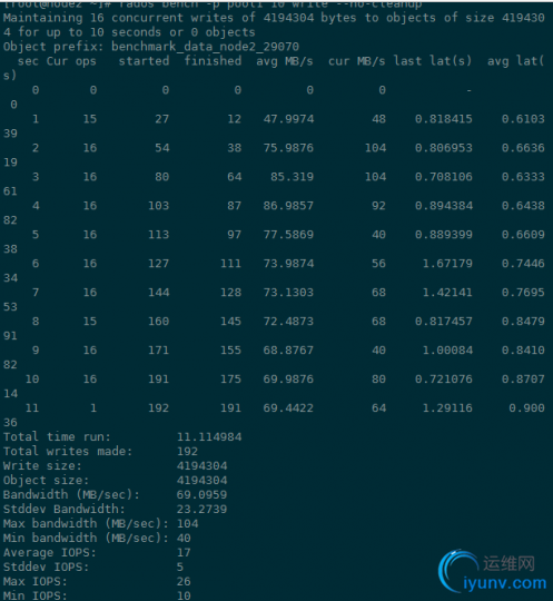

在不清除数据的情况下,进行1000秒的写测试:
[iyunv@node2 ~]# rados bench -p pool1 1000 write --no-cleanup
Total time run:         1003.149409
Total writes made:      6627
Write size:             4194304
Object size:            4194304
Bandwidth (MB/sec):     26.4248
Stddev Bandwidth:       13.4511
Max bandwidth (MB/sec): 116
Min bandwidth (MB/sec): 0
Average IOPS:           6
Stddev IOPS:            3
Max IOPS:               29
Min IOPS:               0
Average Latency(s):     2.42078
Stddev Latency(s):      0.951884
Max latency(s):         6.59119
Min latency(s):         0.119255

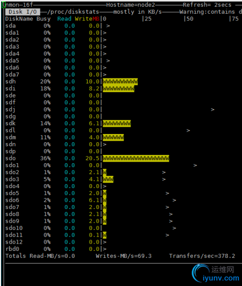

使用nmon查看disk读写情况

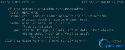

使用watch ceph -s查看集群读写情况
