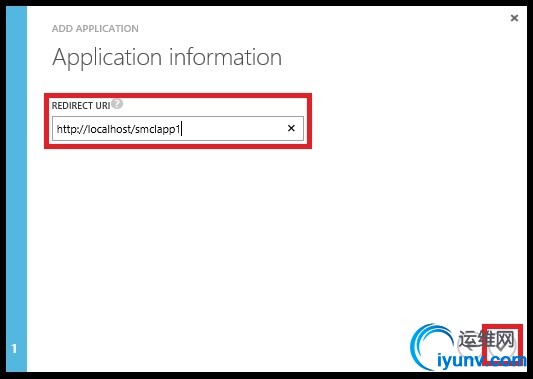

    d.Enter the name of the application, select NATIVE CLIENT APPLICATION, and then click the right arrow.
    e.Enter a URI for the application and then click the checkmark. The URI includes the name of the application that is preceded by http://localhost/.

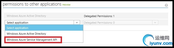

    f.After the application is created, you must add permission for the application to access the Service Management APIs. Go to the page for your application, and then click Configure.

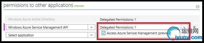

    g.In the Permissions to other applications section at the bottom of the configuration page, click Select application, and then select Windows Azure Service Management API.
    h.Click Delegated Permissions: 0, and then select Access Azure Service Management.
    i.Click Save on the bottom menu.

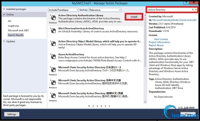

    You can easily install the Active Directory Authentication Library into your Visual Studio project by using the NuGet package. To install the package, do the following:
    1.Right-click the project name in the Solution Explorer, and then click Manage NuGet Packages.
    2.Type Active Directory in the search box, click Install for the Active Directory Authentication Library package, and then follow the instructions to install the package.

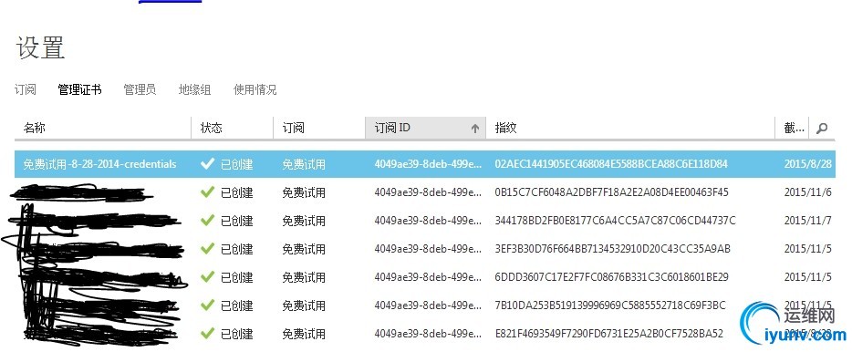

   2.Authenticate using a management certificate(管理证书验证)
   在说管理证书验证之前要先说一下以下两点:
    a.The Service Management API does not verify that a certificate is still valid. Authentication will succeed against an expired certificate.
    b.All management certificates carry the same set of privileges. There is no notion of “role-based” authentication where one management certificate can be configured in one role and another on the same subscription is configured in a different role.
如上面所展示:同一个订阅ID号有多个指纹,通过指纹就可以找到对应的管理证书进行验证;代码如下:
