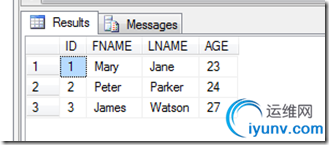

STUDENT_A
STUDENT_B

  So after executing the above code, and if you inspect the Table ‘A’, you can see that it’s updated the way we wanted.

  And if you inspect the table A, you can see that it has the same following results:
