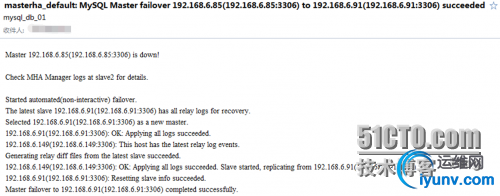

tail-f /tmp/mha_manager.log查看masterha_manager的工作日志。最后看到Master failover to 192.168.6.91(192.168.6.91:3306) completedsuccessfully 即表示主库切换成功。
9
10
11
12
13
14
15
16
-----Failover Report -----
masterha_default:MySQL Master failover 192.168.6.85(192.168.6.85:3306) to192.168.6.91(192.168.6.91:3306) succeeded
Master192.168.6.85(192.168.6.85:3306) is down!
CheckMHA Manager logs at slave2 for details.
Startedautomated(non-interactive) failover.
Thelatest slave 192.168.6.91(192.168.6.91:3306) has all relay logs for recovery.
Selected192.168.6.91(192.168.6.91:3306) as a new master.
192.168.6.91(192.168.6.91:3306):OK: Applying all logs succeeded.
192.168.6.149(192.168.6.149:3306):This host has the latest relay log events.
Generatingrelay diff files from the latest slave succeeded.
192.168.6.149(192.168.6.149:3306):OK: Applying all logs succeeded. Slave started, replicating from 192.168.6.91(192.168.6.91:3306)
192.168.6.91(192.168.6.91:3306):Resetting slave info succeeded.
Masterfailover to 192.168.6.91(192.168.6.91:3306) completed successfully.
对比附录一和附录二的日志信息可以看到如果manager不能ssh到宕掉的服务器的话就不能把日志发保存并发给从库,从库得不到差异日志可能会丢失一部分数据。
切换完成后可以看到邮件告警:

----- Failover Report -----
masterha_default: MySQL Master failover192.168.6.85(192.168.6.85:3306) to 192.168.6.91(192.168.6.91:3306) succeeded
Master 192.168.6.85(192.168.6.85:3306) isdown!
Check MHA Manager logs at slave2 fordetails.
Started automated(non-interactive)failover.
The latest slave192.168.6.91(192.168.6.91:3306) has all relay logs for recovery.
Selected 192.168.6.91(192.168.6.91:3306) asa new master.
192.168.6.91(192.168.6.91:3306): OK:Applying all logs succeeded.
192.168.6.149(192.168.6.149:3306): Thishost has the latest relay log events.
Generating relay diff files from the latestslave succeeded.
192.168.6.149(192.168.6.149:3306): OK:Applying all logs succeeded. Slave started, replicating from192.168.6.91(192.168.6.91:3306)
192.168.6.91(192.168.6.91:3306): Resettingslave info succeeded.
Master failover to192.168.6.91(192.168.6.91:3306) completed successfully.

Mon Jan 18 18:05:49 2016 - [warning] Goterror on MySQL select ping: 2006 (MySQL server has gone away)
Mon Jan 18 18:05:49 2016 - [info] ExecutingSSH check script: save_binary_logs --command=test --start_pos=4--binlog_dir=/data/dbdata/mysqllog/binlog--output_file=/tmp/save_binary_logs_test --manager_version=0.56--binlog_prefix=binlog
Creating /tmp if not exists..   ok.
Checking output directory is accessible or not..
  ok.
Binlog found at /data/dbdata/mysqllog/binlog, up to binlog.000003
Mon Jan 18 18:05:50 2016 - [info]HealthCheck: SSH to 192.168.6.85 is reachable.
Mon Jan 18 18:05:50 2016 - [warning] Goterror on MySQL connect: 2013 (Lost connection to MySQL server at 'readinginitial communication packet', system error: 111)
Mon Jan 18 18:05:50 2016 - [warning]Connection failed 2 time(s)..
Mon Jan 18 18:05:51 2016 - [warning] Goterror on MySQL connect: 2013 (Lost connection to MySQL server at 'readinginitial communication packet', system error: 111)
Mon Jan 18 18:05:51 2016 - [warning]Connection failed 3 time(s)..
Mon Jan 18 18:05:52 2016 - [warning] Goterror on MySQL connect: 2013 (Lost connection to MySQL server at 'readinginitial communication packet', system error: 111)
Mon Jan 18 18:05:52 2016 - [warning]Connection failed 4 time(s)..
Mon Jan 18 18:05:52 2016 - [warning] Masteris not reachable from health checker!
Mon Jan 18 18:05:52 2016 - [warning] Master192.168.6.85(192.168.6.85:3306) is not reachable!
Mon Jan 18 18:05:52 2016 - [warning] SSH isreachable.
Mon Jan 18 18:05:52 2016 - [info]Connecting to a master server failed. Reading configuration file/etc/masterha_default.cnf and /etc/mha/masterha_default.cnf again, and tryingto connect to all servers to check server status..
Mon Jan 18 18:05:52 2016 - [warning] Globalconfiguration file /etc/masterha_default.cnf not found. Skipping.
Mon Jan 18 18:05:52 2016 - [info] Readingapplication default configuration from /etc/mha/masterha_default.cnf..
Mon Jan 18 18:05:52 2016 - [info] Readingserver configuration from /etc/mha/masterha_default.cnf..
Mon Jan 18 18:05:52 2016 - [info] GTIDfailover mode = 0
Mon Jan 18 18:05:52 2016 - [info] DeadServers:
Mon Jan 18 18:05:52 2016 - [info]   192.168.6.85(192.168.6.85:3306)
Mon Jan 18 18:05:52 2016 - [info] AliveServers:
Mon Jan 18 18:05:52 2016 - [info]   192.168.6.91(192.168.6.91:3306)
Mon Jan 18 18:05:52 2016 - [info]   192.168.6.149(192.168.6.149:3306)
Mon Jan 18 18:05:52 2016 - [info] AliveSlaves:
Mon Jan 18 18:05:52 2016 - [info]   192.168.6.91(192.168.6.91:3306)  Version=5.5.33-log (oldest major versionbetween slaves) log-bin:enabled
Mon Jan 18 18:05:52 2016 - [info]     Replicating from192.168.6.85(192.168.6.85:3306)
Mon Jan 18 18:05:52 2016 - [info]     Primary candidate for the new Master(candidate_master is set)
Mon Jan 18 18:05:52 2016 - [info]   192.168.6.149(192.168.6.149:3306)  Version=5.5.33-log (oldest major versionbetween slaves) log-bin:enabled
Mon Jan 18 18:05:52 2016 - [info] Checkingslave configurations..
Mon Jan 18 18:05:52 2016 - [info]  read_only=1 is not set on slave192.168.6.91(192.168.6.91:3306).
Mon Jan 18 18:05:52 2016 - [warning]  relay_log_purge=0 is not set on slave192.168.6.91(192.168.6.91:3306).
Mon Jan 18 18:05:52 2016 - [info]  read_only=1 is not set on slave192.168.6.149(192.168.6.149:3306).
Mon Jan 18 18:05:52 2016 - [warning]  relay_log_purge=0 is not set on slave192.168.6.149(192.168.6.149:3306).
Mon Jan 18 18:05:52 2016 - [info] Checkingreplication filtering settings..
Mon Jan 18 18:05:52 2016 - [info]  Replication filtering check ok.
Mon Jan 18 18:05:52 2016 - [info] Master isdown!
Mon Jan 18 18:05:52 2016 - [info]Terminating monitoring script.
Mon Jan 18 18:05:52 2016 - [info] Got exitcode 20 (Master dead).
Mon Jan 18 18:05:52 2016 - [info]MHA::MasterFailover version 0.56.
Mon Jan 18 18:05:52 2016 - [info] Startingmaster failover.
Mon Jan 18 18:05:52 2016 - [info] * Phase1: Configuration Check Phase..
Mon Jan 18 18:05:53 2016 - [info] GTIDfailover mode = 0
Mon Jan 18 18:05:53 2016 - [info] DeadServers:
Mon Jan 18 18:05:53 2016 - [info]   192.168.6.85(192.168.6.85:3306)
Mon Jan 18 18:05:53 2016 - [info] Checkingmaster reachability via MySQL(double check)...
Mon Jan 18 18:05:53 2016 - [info]  ok.
Mon Jan 18 18:05:53 2016 - [info] AliveServers:
Mon Jan 18 18:05:53 2016 - [info]   192.168.6.91(192.168.6.91:3306)
Mon Jan 18 18:05:53 2016 - [info]   192.168.6.149(192.168.6.149:3306)
Mon Jan 18 18:05:53 2016 - [info] AliveSlaves:
Mon Jan 18 18:05:53 2016 - [info]   192.168.6.91(192.168.6.91:3306)  Version=5.5.33-log (oldest major versionbetween slaves) log-bin:enabled
Mon Jan 18 18:05:53 2016 - [info]     Replicating from192.168.6.85(192.168.6.85:3306)
Mon Jan 18 18:05:53 2016 - [info]     Primary candidate for the new Master(candidate_master is set)
Mon Jan 18 18:05:53 2016 - [info]   192.168.6.149(192.168.6.149:3306)  Version=5.5.33-log (oldest major versionbetween slaves) log-bin:enabled
Mon Jan 18 18:05:53 2016 - [info] StartingNon-GTID based failover.
Mon Jan 18 18:05:53 2016 - [info] ** Phase1: Configuration Check Phase completed.
Mon Jan 18 18:05:53 2016 - [info] * Phase2: Dead Master Shutdown Phase..
Mon Jan 18 18:05:53 2016 - [info] Forcingshutdown so that applications never connect to the current master..
Mon Jan 18 18:05:53 2016 - [warning]master_ip_failover_script is not set. Skipping invalidating dead master IPaddress.
Mon Jan 18 18:05:53 2016 - [warning] shutdown_scriptis not set. Skipping explicit shutting down of the dead master.
Mon Jan 18 18:05:53 2016 - [info] * Phase2: Dead Master Shutdown Phase completed.
Mon Jan 18 18:05:53 2016 - [info] * Phase3: Master Recovery Phase..
Mon Jan 18 18:05:53 2016 - [info] * Phase3.1: Getting Latest Slaves Phase..
Mon Jan 18 18:05:53 2016 - [info] Thelatest binary log file/position on all slaves is binlog.000003:107
Mon Jan 18 18:05:53 2016 - [info] Latestslaves (Slaves that received relay log files to the latest):
Mon Jan 18 18:05:53 2016 - [info] Theoldest binary log file/position on all slaves is binlog.000003:107
Mon Jan 18 18:05:53 2016 - [info] Oldestslaves:
Mon Jan 18 18:05:53 2016 - [info]     Replicating from 192.168.6.85(192.168.6.85:3306)
Mon Jan 18 18:05:53 2016 - [info] * Phase3.2: Saving Dead Master's Binlog Phase..
Mon Jan 18 18:05:53 2016 - [info] Fetchingdead master's binary logs..
Mon Jan 18 18:05:53 2016 - [info] Executingcommand on the dead master 192.168.6.85(192.168.6.85:3306): save_binary_logs--command=save --start_file=binlog.000003 --start_pos=107 --binlog_dir=/data/dbdata/mysqllog/binlog--output_file=/tmp/saved_master_binlog_from_192.168.6.85_3306_20160118180552.binlog--handle_raw_binlog=1 --disable_log_bin=0 --manager_version=0.56
Concat binary/relay logs from binlog.000003pos 107 to binlog.000003 EOF into/tmp/saved_master_binlog_from_192.168.6.85_3306_20160118180552.binlog ..
Dumping binlog format description event, from position 0 to 107.. ok.
Dumping effective binlog data from /data/dbdata/mysqllog/binlog/binlog.000003position 107 to tail(126).. ok.
Concat succeeded.
Mon Jan 18 18:05:54 2016 - [info] scp fromroot@192.168.6.85:/tmp/saved_master_binlog_from_192.168.6.85_3306_20160118180552.binlogto local:/var/tmp/saved_master_binlog_from_192.168.6.85_3306_20160118180552.binlogsucceeded.
Mon Jan 18 18:05:54 2016 - [info]HealthCheck: SSH to 192.168.6.91 is reachable.
Mon Jan 18 18:05:55 2016 - [info]HealthCheck: SSH to 192.168.6.149 is reachable.
Mon Jan 18 18:05:55 2016 - [info] * Phase3.3: Determining New Master Phase..
Mon Jan 18 18:05:55 2016 - [info] Findingthe latest slave that has all relay logs for recovering other slaves..
Mon Jan 18 18:05:55 2016 - [info] Allslaves received relay logs to the same position. No need to resync each other.
Mon Jan 18 18:05:55 2016 - [info] Searchingnew master from slaves..
Mon Jan 18 18:05:55 2016 - [info]  Candidate masters from the configurationfile:
Mon Jan 18 18:05:55 2016 - [info]   192.168.6.91(192.168.6.91:3306)  Version=5.5.33-log (oldest major versionbetween slaves) log-bin:enabled
Mon Jan 18 18:05:55 2016 - [info]     Replicating from192.168.6.85(192.168.6.85:3306)
Mon Jan 18 18:05:55 2016 - [info]     Primary candidate for the new Master(candidate_master is set)
Mon Jan 18 18:05:55 2016 - [info]  Non-candidate masters:
Mon Jan 18 18:05:55 2016 - [info]  Searching from candidate_master slaves whichhave received the latest relay log events..
Mon Jan 18 18:05:55 2016 - [info] New masteris 192.168.6.91(192.168.6.91:3306)
Mon Jan 18 18:05:55 2016 - [info] Startingmaster failover..
From:
192.168.6.85(192.168.6.85:3306) (currentmaster)
+--192.168.6.91(192.168.6.91:3306)
+--192.168.6.149(192.168.6.149:3306)
To:
192.168.6.91(192.168.6.91:3306) (newmaster)
Mon Jan 18 18:05:55 2016 - [info] * Phase3.3: New Master Diff Log Generation Phase..
Mon Jan 18 18:05:55 2016 - [info]  This server has all relay logs. No need togenerate diff files from the latest slave.
Mon Jan 18 18:05:55 2016 - [info] Sendingbinlog..
Mon Jan 18 18:05:55 2016 - [info] scp fromlocal:/var/tmp/saved_master_binlog_from_192.168.6.85_3306_20160118180552.binlogtoroot@192.168.6.91:/tmp/saved_master_binlog_from_192.168.6.85_3306_20160118180552.binlogsucceeded.
Mon Jan 18 18:05:55 2016 - [info] * Phase3.4: Master Log Apply Phase..
Mon Jan 18 18:05:55 2016 - [info] *NOTICE:If any error happens from this phase, manual recovery is needed.
Mon Jan 18 18:05:55 2016 - [info] Startingrecovery on 192.168.6.91(192.168.6.91:3306)..
Mon Jan 18 18:05:55 2016 - [info]  Generating diffs succeeded.
Mon Jan 18 18:05:55 2016 - [info] Waitinguntil all relay logs are applied.
Mon Jan 18 18:05:55 2016 - [info]  done.
Mon Jan 18 18:05:55 2016 - [info] Gettingslave status..
Mon Jan 18 18:05:55 2016 - [info] Thisslave(192.168.6.91)'s Exec_Master_Log_Pos equals toRead_Master_Log_Pos(binlog.000003:107). No need to recover fromExec_Master_Log_Pos.
Mon Jan 18 18:05:55 2016 - [info]Connecting to the target slave host 192.168.6.91, running recover script..
Mon Jan 18 18:05:55 2016 - [info] Executingcommand: apply_diff_relay_logs --command=apply --slave_user='root'--slave_host=192.168.6.91 --slave_ip=192.168.6.91  --slave_port=3306--apply_files=/tmp/saved_master_binlog_from_192.168.6.85_3306_20160118180552.binlog--workdir=/tmp --target_version=5.5.33-log --timestamp=20160118180552--handle_raw_binlog=1 --disable_log_bin=0 --manager_version=0.56--slave_pass=xxx
Mon Jan 18 18:05:56 2016 - [info]
Applying differential binary/relay logfiles /tmp/saved_master_binlog_from_192.168.6.85_3306_20160118180552.binlog on192.168.6.91:3306. This may take long time...
Applying log files succeeded.
Mon Jan 18 18:05:56 2016 - [info]  All relay logs were successfully applied.
Mon Jan 18 18:05:56 2016 - [info] Gettingnew master's binlog name and position..
Mon Jan 18 18:05:56 2016 - [info]  binlog.000003:107
Mon Jan 18 18:05:56 2016 - [info]  All other slaves should start replicationfrom here. Statement should be: CHANGE MASTER TO MASTER_HOST='192.168.6.91',MASTER_PORT=3306, MASTER_LOG_FILE='binlog.000003', MASTER_LOG_POS=107,MASTER_USER='repl', MASTER_PASSWORD='xxx';
Mon Jan 18 18:05:56 2016 - [warning]master_ip_failover_script is not set. Skipping taking over new master IPaddress.
Mon Jan 18 18:05:56 2016 - [info] **Finished master recovery successfully.
Mon Jan 18 18:05:56 2016 - [info] * Phase3: Master Recovery Phase completed.
Mon Jan 18 18:05:56 2016 - [info] * Phase4: Slaves Recovery Phase..
Mon Jan 18 18:05:56 2016 - [info] * Phase4.1: Starting Parallel Slave Diff Log Generation Phase..
Mon Jan 18 18:05:56 2016 - [info] -- Slavediff file generation on host 192.168.6.149(192.168.6.149:3306) started, pid:32132. Check tmp log /var/tmp/192.168.6.149_3306_20160118180552.log if it takestime..
Mon Jan 18 18:05:56 2016 - [info] Logmessages from 192.168.6.149 ...
Mon Jan 18 18:05:56 2016 - [info]  This server has all relay logs. No need togenerate diff files from the latest slave.
Mon Jan 18 18:05:56 2016 - [info] End oflog messages from 192.168.6.149.
Mon Jan 18 18:05:56 2016 - [info] --192.168.6.149(192.168.6.149:3306) has the latest relay log events.
Mon Jan 18 18:05:56 2016 - [info]Generating relay diff files from the latest slave succeeded.
Mon Jan 18 18:05:56 2016 - [info] * Phase4.2: Starting Parallel Slave Log Apply Phase..
Mon Jan 18 18:05:56 2016 - [info] -- Slaverecovery on host 192.168.6.149(192.168.6.149:3306) started, pid: 32134. Checktmp log /var/tmp/192.168.6.149_3306_20160118180552.log if it takes time..
Mon Jan 18 18:05:57 2016 - [info]
Mon Jan 18 18:05:57 2016 - [info] Log messagesfrom 192.168.6.149 ...
Mon Jan 18 18:05:56 2016 - [info] Sendingbinlog..
