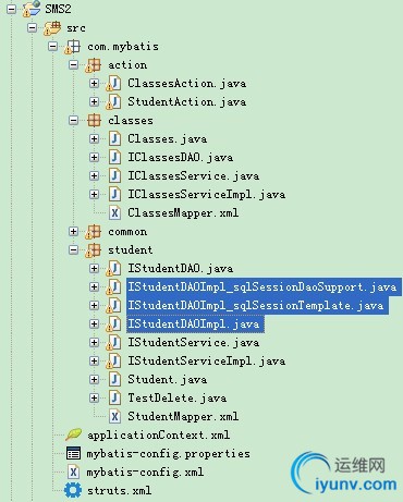

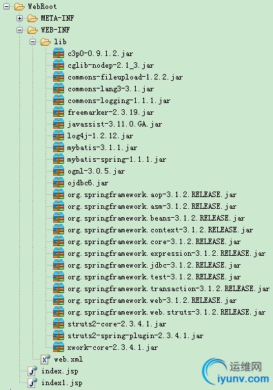

MyBatis3.1.1+Spring3.1.2+Struts2.3.4.1
先来看目录结构
来看配置文件

//同样是 创建一个 可以批量操作的 sqlSession
public IStudentDAOImpl_sqlSessionTemplate(
SqlSessionFactory sqlSessionFactory) {
super(sqlSessionFactory);
// TODO Auto-generated constructor stub
public int addStudent(Student student) {
// TODO Auto-generated method stub
return this.insert("com.mybatis.student.addStudent", student);
public int addStudentBySequence(Student student) {
return this.insert("com.mybatis.student.addStudentBySequence", student);
public int delStudentById(int id) {
int rows=this.delete("com.mybatis.student.delStudentById", id);
System.out.println(rows);
return rows;
public List<Student> queryAllStudent() {
List<Student> stuList=new ArrayList<Student>();
stuList=this.selectList("com.mybatis.student.queryAllStudent");
return stuList;
public Student queryStudentById(int id) {
return (Student)this.selectOne("com.mybatis.student.queryStudentById",id);
public Map getAllStudentAfterupdate(Map map) {
this.selectOne("com.mybatis.student.getAllStudentAfterupdate",map);
return map;
public Classes selectClassAndStudentListById(int id) {
return (Classes)this.selectOne("com.mybatis.classes.selectClassAndStudentListById",id);
public List<Student> selectStudentAndClassBySname(String sname) {
stuList=this.selectList("com.mybatis.student.selectStudentAndClassBySname",sname);
return stuList;
public List<Student> selectStudentByDynamicSql(Student student) {
return this.selectList("com.mybatis.student.selectStudentByDynamicSql",student);
public List<Student> selectStudentByDynamicSqlChoose(Student student) {
return this.selectList("com.mybatis.student.selectStudentByDynamicSqlChoose",student);
public List<Student> selectStudentByIdArray(Integer[] idArry) {
return this.selectList("com.mybatis.student.selectStudentByIdArray",idArry);
public List<Student> selectStudentByIds(ArrayList<Integer> ids) {
return this.selectList("com.mybatis.student.selectStudentByIds",ids);
public List<Student> studentResultMap(String sname) {
return this.selectList("com.mybatis.student.selectMapResult",sname);
public List<Student> queryStudentByName(Student name) {
stuList=this.selectList("com.mybatis.student.queryStudentByName","%"+name+"%");
return stuList;
public int updStudentById(Student student) {
return this.update("com.mybatis.student.addStudentBySequence", student);
IClassesDAO.java
package com.mybatis.classes;
* 使用  MapperFactoryBean 来管理 sqlSession
* @author Administrator
public interface IClassesDAO {
// 也可以在这里使用注解配置 sql语句  这样就不用写 映射文件了
Classes selectClassAndStudentListById(int cid);
int delClassesBycid(int cid);
Student.java
package com.mybatis.student;
import java.io.Serializable;
import java.util.Date;
import com.mybatis.classes.Classes;
public class Student implements Serializable {
private int sid;
private String sname;
private String major;
private Date birth;
private float score;
private int cid;
private int status;
//get set()
