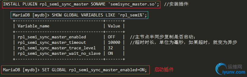

☉半同步复制:
  • master只保证slaves中的一个操作成功,就返回,其他slave不管。这个功能,是由google为MYSQL引入的。

3.半同步复制
★支持多种插件:
  • /usr/lib64/mysql/plugins/
★需要安装插件方可使用:
  • mysql> INSTALL PLUGIN plugin_name SONAME 'shared_library_name';
★半同步复制:
  • semisync_master.so
  • semisync_slave.so
★主节点:
★从节点:

MariaDB [(none)]> INSTALL PLUGIN rpl_semi_sync_master SONAME 'semisync_master.so';
Query OK, 0 rows affected (0.16 sec)
# 查看是否安装的插件 semisync_master.so 是否激活
MariaDB [(none)]> SHOW PLUGINS;
| Name                           | Status   | Type               | Library            | License |
| binlog                         | ACTIVE   | STORAGE ENGINE     | NULL               | GPL     |
| mysql_native_password          | ACTIVE   | AUTHENTICATION     | NULL               | GPL     |
| mysql_old_password             | ACTIVE   | AUTHENTICATION     | NULL               | GPL     |
| INNODB_BUFFER_PAGE_LRU         | ACTIVE   | INFORMATION SCHEMA | NULL               | GPL     |
| INNODB_BUFFER_POOL_STATS       | ACTIVE   | INFORMATION SCHEMA | NULL               | GPL     |
| FEDERATED                      | ACTIVE   | STORAGE ENGINE     | NULL               | GPL     |
| BLACKHOLE                      | ACTIVE   | STORAGE ENGINE     | NULL               | GPL     |
| Aria                           | ACTIVE   | STORAGE ENGINE     | NULL               | GPL     |
| FEEDBACK                       | DISABLED | INFORMATION SCHEMA | NULL               | GPL     |
| partition                      | ACTIVE   | STORAGE ENGINE     | NULL               | GPL     |
| rpl_semi_sync_master           | ACTIVE   | REPLICATION        | semisync_master.so | GPL     |
43 rows in set (0.01 sec)
MariaDB [(none)]> SHOW GLOBAL VARIABLES LIKE 'rpl_semi%';
| Variable_name                      | Value |
| rpl_semi_sync_master_enabled       | OFF   |  # 现在为关闭状态
| rpl_semi_sync_master_timeout       | 10000 |
| rpl_semi_sync_master_trace_level   | 32    |
| rpl_semi_sync_master_wait_no_slave | ON    |
4 rows in set (0.00 sec)
MariaDB [(none)]> SET GLOBAL rpl_semi_sync_master_enabled=ON;  # 启动插件
| rpl_semi_sync_master_enabled       | ON    |  # 已经启动
| rpl_semi_sync_master_timeout       | 10000 |  # 超时时长,超过会降为异步复制
4 rows in set (0.01 sec)
