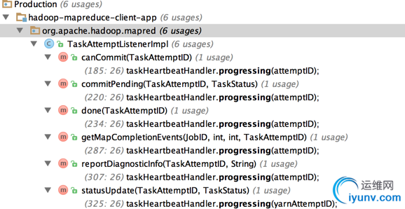

public void progressing(TaskAttemptId attemptID) {
//only put for the registered attempts
//TODO throw an exception if the task isn't registered.
ReportTime time = runningAttempts.get(attemptID);
if(time != null) {
time.setLastProgress(clock.getTime());
在TaskAttemptListenerImpl类中会调用报告进度的方法,在任务的不同阶段,都会对任务向ApplicationMaster报告,提交进度信息。更详细的方法这里就不再深入研究。
