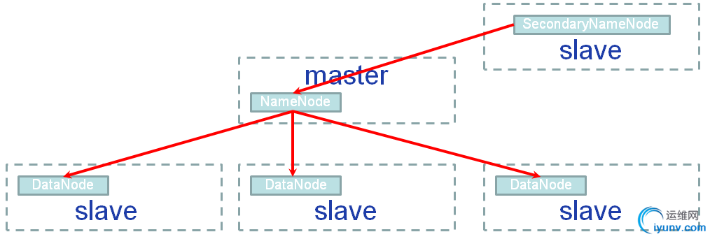

2.1 hadoop1.x和hadoop2.x都支持的namenode+secondarynamenode方式

  集群方式一(hadoop1.x和hadoop2.x都支持的namenode+secondarynamenode方式)
  http://hadoop.apache.org/docs/r2.7.2/hadoop-project-dist/hadoop-common/ClusterSetup.html

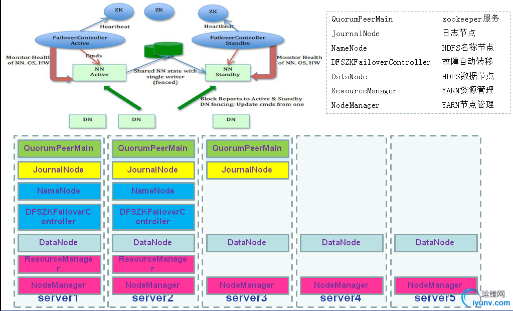

  集群方式二(仅hadoop2.x支持的active namenode+standby namenode方式,也叫HADOOP HA方式),这种方式又将HDFS的HA和YARN的HA单独分开讲解
  HDFS HA(zookeeper+journalnode)http://hadoop.apache.org/docs/r2.7.2/hadoop-project-dist/hadoop-hdfs/HDFSHighAvailabilityWithQJM.html
  HDFS HA(zookeeper+NFS)http://hadoop.apache.org/docs/r2.7.2/hadoop-project-dist/hadoop-hdfs/HDFSHighAvailability
   YARN HA(zookeeper)http://hadoop.apache.org/docs/r2.7.2/hadoop-yarn/hadoop-yarn-site/ResourceManagerHA.html
  生产环境多采用HDFS(zookeeper+journalnode)(active NameNode+standby NameNode+JournalNode+DFSZKFailoverController+DataNode)+YARN(zookeeper)(active ResourceManager+standby ResourceManager+NodeManager)方式,这里我讲解的是hadoop1.x和hadoop2.x都支持的namenode+secondarynamenode方式,这种方式主要用于学习实践,因为它需要的机器台数低但存在namenode单节点问题

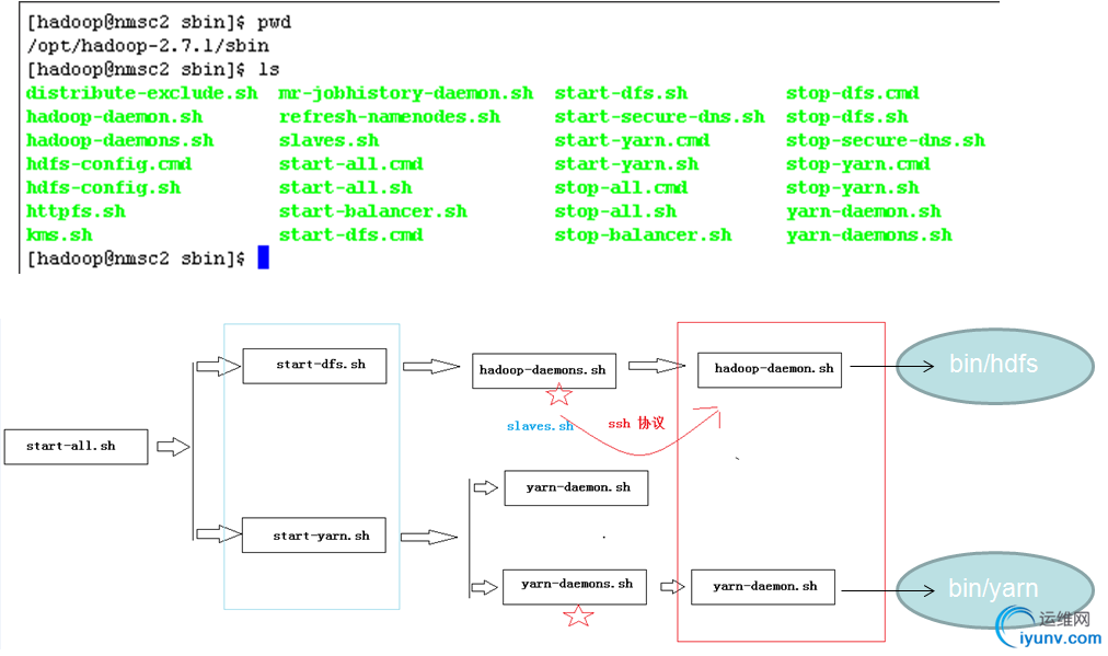

  (3)停止的话,输入命令,./stop-all.sh
  关于Hadoop相关shell命令调用关系,见下图:
