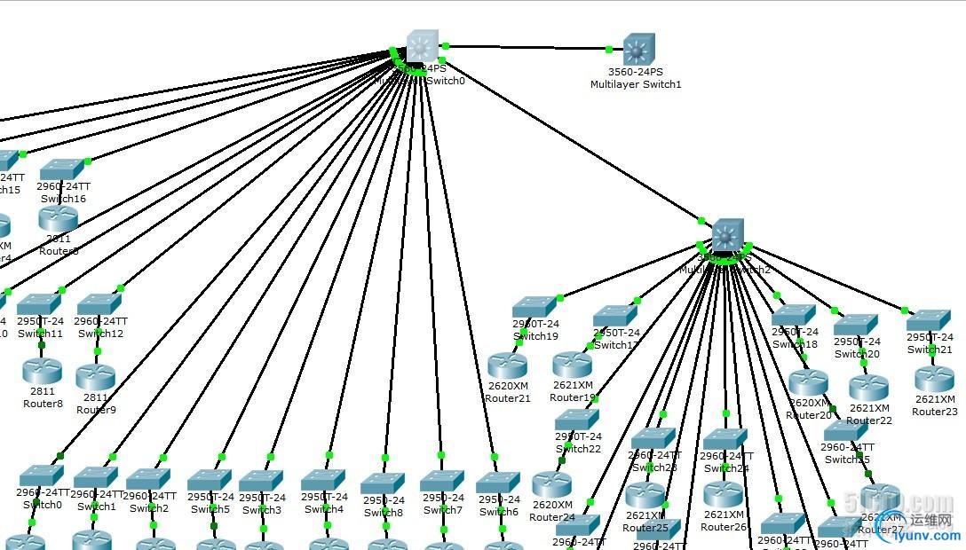

SW0配置:
Switch#sh run
Building configuration...
Current configuration : 2500 bytes
version 12.2
no service timestamps log datetime msec
no service timestamps debug datetime msec
no service password-encryption
hostname Switch
ip routing
interface FastEthernet0/1
switchport access vlan 10
interface FastEthernet0/2
interface FastEthernet0/3
interface FastEthernet0/4
interface FastEthernet0/5
no switchport
ip address 10.1.5.1 255.255.255.0
duplex auto
speed auto
interface FastEthernet0/6
no switchport
ip address 10.1.6.1 255.255.255.0
duplex auto
speed auto
interface FastEthernet0/7
no switchport
ip address 10.1.7.1 255.255.255.0
duplex auto
speed auto
interface FastEthernet0/8
no switchport
ip address 10.1.8.1 255.255.255.0
duplex auto
speed auto
interface FastEthernet0/9
no switchport
ip address 192.168.9.1 255.255.255.0
duplex auto
speed auto
interface FastEthernet0/10
no switchport
ip address 192.168.10.1 255.255.255.0
duplex auto
speed auto
interface FastEthernet0/11
no switchport
ip address 192.168.11.1 255.255.255.0
duplex auto
speed auto
interface FastEthernet0/12
no switchport
ip address 192.168.12.1 255.255.255.0
duplex auto
speed auto
interface FastEthernet0/13
no switchport
ip address 192.168.13.1 255.255.255.0
duplex auto
speed auto
interface FastEthernet0/14
no switchport
ip address 192.168.14.1 255.255.255.0
duplex auto
speed auto
interface FastEthernet0/15
no switchport
ip address 192.168.15.1 255.255.255.0
duplex auto
speed auto
interface FastEthernet0/16
no switchport
ip address 192.168.16.1 255.255.255.0
duplex auto
speed auto
interface FastEthernet0/17
no switchport
ip address 192.168.17.1 255.255.255.0
duplex auto
speed auto
interface FastEthernet0/18
interface FastEthernet0/19
interface FastEthernet0/20
interface FastEthernet0/21
interface FastEthernet0/22
interface FastEthernet0/23
no switchport
ip address 172.16.18.3 255.255.255.0
duplex auto
speed auto
interface FastEthernet0/24
no switchport
ip address 10.1.80.1 255.255.255.0
duplex full
speed 100
interface GigabitEthernet0/1
interface GigabitEthernet0/2
interface Vlan1
no ip address
shutdown
interface Vlan10
ip address 10.1.1.1 255.255.255.0
router eigrp 100
network 172.16.0.0
network 10.1.0.0 0.0.255.255
network 192.168.0.0 0.0.255.255
no auto-summary
ip classless
line con 0
line vty 0 4
login
end
SW2配置:
Switch#sh run
Current configuration : 2507 bytes
version 12.2
hostname Switch
ip routing
no switchport
ip address 172.16.1.1 255.255.255.0
duplex auto
speed auto
no switchport
ip address 172.16.2.1 255.255.255.0
duplex auto
speed auto
no switchport
ip address 172.16.3.1 255.255.255.0
duplex auto
speed auto
no switchport
ip address 172.16.4.1 255.255.255.0
duplex auto
speed auto
no switchport
ip address 172.16.5.1 255.255.255.0
duplex auto
speed auto
no switchport
ip address 172.16.6.1 255.255.255.0
duplex auto
speed auto
no switchport
ip address 172.16.7.1 255.255.255.0
duplex auto
speed auto
no switchport
ip address 172.16.8.1 255.255.255.0
duplex auto
speed auto
no switchport
ip address 172.16.9.1 255.255.255.0
duplex auto
speed auto
no switchport
ip address 172.16.10.1 255.255.255.0
duplex auto
speed auto
no switchport
ip address 172.16.11.1 255.255.255.0
duplex auto
speed auto
no switchport
ip address 172.16.12.1 255.255.255.0
duplex auto
speed auto
no switchport
ip address 172.16.13.1 255.255.255.0
duplex auto
speed auto
no switchport
ip address 172.16.14.1 255.255.255.0
duplex auto
speed auto
no switchport
ip address 172.16.15.1 255.255.255.0
duplex auto
speed auto
no switchport
ip address 172.16.16.1 255.255.255.0
duplex auto
speed auto
no switchport
ip address 172.16.17.1 255.255.255.0
duplex auto
speed auto
no switchport
ip address 172.16.18.2 255.255.255.0
duplex auto
speed auto
interface Vlan1
no ip address
shutdown
router eigrp 100
network 172.16.0.0
no auto-summary
ip classless
line con 0
line vty 0 4
login
end
