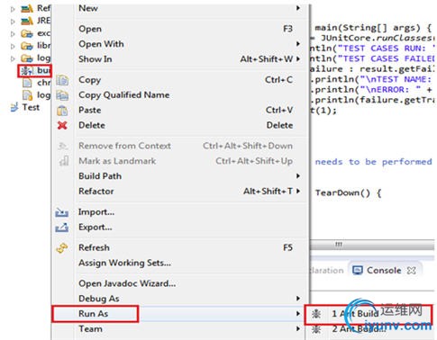

The easiest section is to execute the test suite with Ant. To execute the test suite with Ant, Right click on “build.xml” and select “Run As -> Ant Build” option. Thus, the option hits the execution. Refer the following figure for the same.
After the entire execution is completed, Ant generates a test execution report for review inside the “Report” folder.
The execution can also be initiated outside the eclipse by hitting the command on the command prompt. User is expected to navigate to the directory where build.xml is kept and type “ant”.
