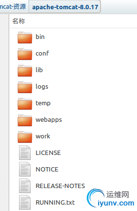

  打开已经解压好来的tomcat可以看到如下目录和文件

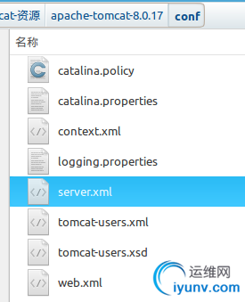

  打开conf文件夹目录如下(这里存放着tomcat的配置文件)
  使用文本编辑器gedit等打开server.xml

Documentation at /docs/config/server.html
<Server port="8006" shutdown="SHUTDOWN">
<Listener className="org.apache.catalina.startup.VersionLoggerListener" />
<!-- Security listener. Documentation at /docs/config/listeners.html
<Listener className="org.apache.catalina.security.SecurityListener" />
<!--APR library loader. Documentation at /docs/apr.html -->
<Listener className="org.apache.catalina.core.AprLifecycleListener" SSLEngine="on" />
<!-- Prevent memory leaks due to use of particular java/javax APIs-->
<Listener className="org.apache.catalina.core.JreMemoryLeakPreventionListener" />
<Listener className="org.apache.catalina.mbeans.GlobalResourcesLifecycleListener" />
<Listener className="org.apache.catalina.core.ThreadLocalLeakPreventionListener" />
<!-- Global JNDI resources
Documentation at /docs/jndi-resources-howto.html
<GlobalNamingResources>
<!-- Editable user database that can also be used by
UserDatabaseRealm to authenticate users
<Resource name="UserDatabase" auth="Container"
type="org.apache.catalina.UserDatabase"
description="User database that can be updated and saved"
factory="org.apache.catalina.users.MemoryUserDatabaseFactory"
pathname="conf/tomcat-users.xml" />
</GlobalNamingResources>
<!-- A "Service" is a collection of one or more "Connectors" that share
a single "Container" Note:  A "Service" is not itself a "Container",
so you may not define subcomponents such as "Valves" at this level.
Documentation at /docs/config/service.html
<Service name="Catalina">
<!--The connectors can use a shared executor, you can define one or more named thread pools-->
<Executor name="tomcatThreadPool" namePrefix="catalina-exec-"
maxThreads="150" minSpareThreads="4"/>
<!-- A "Connector" represents an endpoint by which requests are received
and responses are returned. Documentation at :
Java HTTP Connector: /docs/config/http.html (blocking & non-blocking)
Java AJP  Connector: /docs/config/ajp.html
APR (HTTP/AJP) Connector: /docs/apr.html
Define a non-SSL/TLS HTTP/1.1 Connector on port 8080
<Connector port="8082" protocol="HTTP/1.1"
connectionTimeout="20000"
redirectPort="8442" />
<!-- A "Connector" using the shared thread pool-->
<Connector executor="tomcatThreadPool"
<!-- Define a SSL/TLS HTTP/1.1 Connector on port 8443
This connector uses the NIO implementation that requires the JSSE
style configuration. When using the APR/native implementation, the
OpenSSL style configuration is required as described in the APR/native
documentation -->
<Connector port="8442" protocol="org.apache.coyote.http11.Http11NioProtocol"
maxThreads="150" SSLEnabled="true" scheme="https" secure="true"
clientAuth="false" sslProtocol="TLS" />
<!-- Define an AJP 1.3 Connector on port 8009 -->
<Connector port="8029" protocol="AJP/1.3" redirectPort="8442" />
<!-- An Engine represents the entry point (within Catalina) that processes
every request.  The Engine implementation for Tomcat stand alone
analyzes the HTTP headers included with the request, and passes them
on to the appropriate Host (virtual host).
Documentation at /docs/config/engine.html -->
<!-- You should set jvmRoute to support load-balancing via AJP ie :
<Engine name="Catalina" defaultHost="localhost" jvmRoute="jvm1">
<Engine name="Catalina" defaultHost="localhost">
<!--For clustering, please take a look at documentation at:
/docs/cluster-howto.html  (simple how to)
/docs/config/cluster.html (reference documentation) -->
<Cluster className="org.apache.catalina.ha.tcp.SimpleTcpCluster"/>
<!-- Use the LockOutRealm to prevent attempts to guess user passwords
via a brute-force attack -->
<Realm className="org.apache.catalina.realm.LockOutRealm">
<!-- This Realm uses the UserDatabase configured in the global JNDI
resources under the key "UserDatabase".  Any edits
that are performed against this UserDatabase are immediately
available for use by the Realm.  -->
<Realm className="org.apache.catalina.realm.UserDatabaseRealm"
resourceName="UserDatabase"/>
</Realm>
<Host name="localhost"  appBase="webapps"
unpackWARs="true" autoDeploy="true">
<!-- SingleSignOn valve, share authentication between web applications
Documentation at: /docs/config/valve.html -->
<Valve className="org.apache.catalina.authenticator.SingleSignOn" />
<!-- Access log processes all example.
Note: The pattern used is equivalent to using pattern="common" -->
<Valve className="org.apache.catalina.valves.AccessLogValve" directory="logs"
prefix="localhost_access_log" suffix=".txt"
pattern="%h %l %u %t &quot;%r&quot; %s %b" />
</Host>
</Engine>
</Service>
</Server>
  红色部分的内容即为必须修改的内容,因为端口在计算机中不允许重复的绑定。
  这个在升级tomcat时很方便
  下面新建一个bin目录
  增加一下两个启动,关闭脚本
  start.sh
#! /bin/bash
CATALINA_BASE="/home/lkl/tomcat-instance/new_tomcat_instance"
CATALINA_HOME="/home/lkl/tomcat-instance/apache-tomcat-8.0.17"
export CATALINA_BASE CATALINA_HOME
echo "$CATALINA_HOME"
echo $PATH
$CATALINA_HOME/bin/catalina.sh run
  授权 chmod u+x start.sh或者 chmod 764 start.sh
  stop.sh
#! /bin/bash
echo $PATH
$CATALINA_HOME/bin/catalina.sh stop
  授权 chmod u+x stop.sh或者 chmod 764 stop.sh
  要启动实例直接运行接本既可(还可以扩展更多的脚本根据catalina.sh的脚本命令)
  原理参考:http://www.cher7.com/?id=12919,感谢作者
