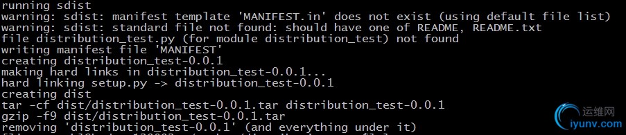

  3.build
  执行$python setup.py sdist
  然后得到目录:
  distribution_test
  |-distribution_test.py
  |- MANIFEST
  |-setup.py
  |-dist
  |-distribution_test-0.0.1.tar.gz
